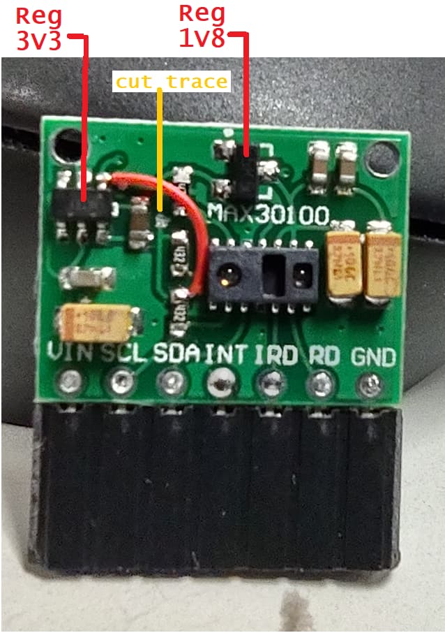

This is why I suspect there's trouble with mixing the MAX30100's 3V3 and the MLX90614 (and there's a 3V and a 5V version of that).

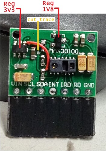

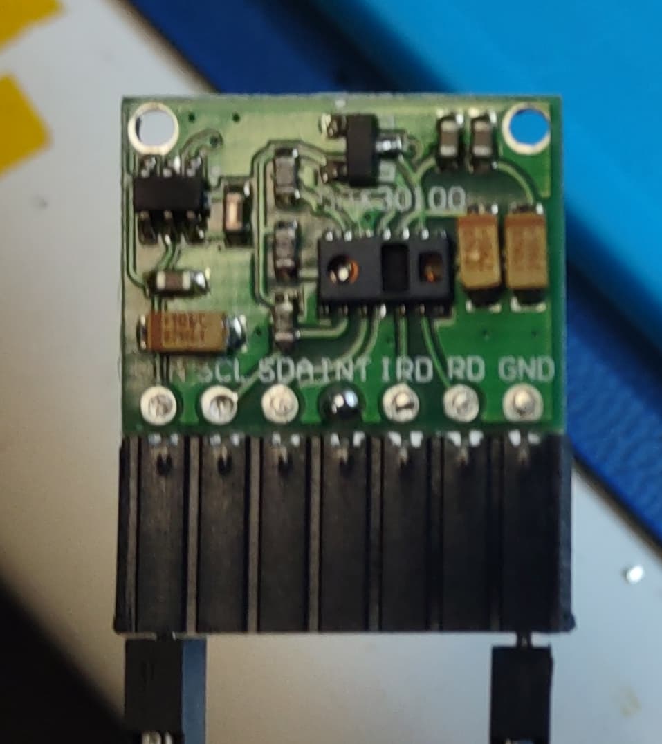

Are you using one of these?
I bought one (this one) and I see, with the DVM, that SDA and SCL are pulled up to 1.8V

For the record, I modified my board so that its SCL and SDA are pulled-up to its (onboard) 3V3 --
and then I run those into a 3v-5V level shifter.

Post links to the exact boards you used. I don't expect you to use the sensor chips directly so we need to know what other components are on the boards. I guess, each board has on-board pull-ups so the sinking current got too big but that's wild guessing without knowing the exact circuitry.
All I2C devices use different power voltages (given you use the mostly used 3.3V version of the MLX90614) so the bus voltage may be another problem.
