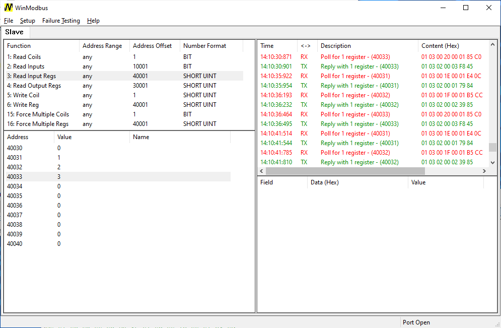

So this got me a bit intrigued. I don't have one of those soil sensors, so I used the demo version of WinModbus to simulate it. I also modified the code slightly to print out differently.

And here's a screen capture from WinModbus:
I've given the raw values 1, 2 & 3 to the three registers holding Nitrogen, Phosphorus & Potassium. And this is what the serial monitor shows from sketch start:
   Nitrogen: FF FF FF FF FF FF FF  = 255 mg/kg
Phosphorous: 1 3 2 0 1 79 84  = 1 mg/kg
  Potassium: 1 3 2 0 2 39 85  = 2 mg/kg
   Nitrogen: 1 3 2 0 3 F8 45  = 3 mg/kg
The initial value received on the first request is garbage, but after that all the responses are out by 1 message. Compare the raw Phosphorus response which the sketch displays to the message that WinModbus has actually sent. The sketch is displaying the response that belongs to the Nitrogen query.
At first glance, I can't see if i've missed something obvious but I'll report back with more if I do figure this out!

The output from the code when talking to the simulated sensor (using WinModbus) now looks like:
   Nitrogen: 1 3 2 0 1 79 84  = 1 mg/kg
Phosphorous: 1 3 2 0 2 39 85  = 2 mg/kg
  Potassium: 1 3 2 0 3 F8 45  = 3 mg/kg
At least now the response is working correctly. I don't know why there was a problem with the original SoftwareSerial code. The original author must have got it working so maybe an update to the library broke something along the way.
EDIT: I tried a slightly different Modbus simulator called ModRSsim2 and had to tweak the crude delay to 200ms before reading in the data, otherwise it always reported back 0xFF (= -1) indicating that there was no data to read.
