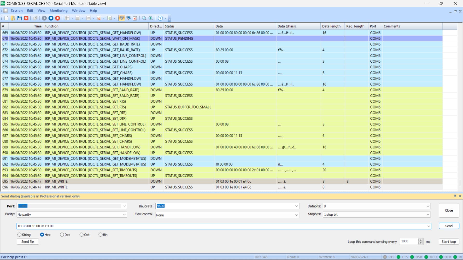

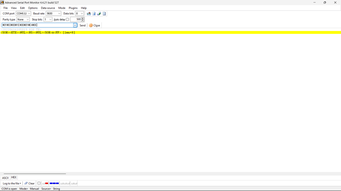

@markd833 , I checked in 2 different software. I got this as response.
The top screenshot seems to show the correct data being transmitted. The bottom screenshot seems to show the wrong data being transmitted - the final byte looks wrong.
I'm at a loss as to what suggest next.
In both the response was same Γ€. In 1st screenshot check the last line response.

We've taken the Arduino out of the equation, so we know it's not a code issue.
If we assume that the PC applications are behaving correctly, and you've swapped A & B over and still not been able to communicate with the NPK sensor with a simple PC app, then I'm at the limit of my knowledge on what the problem could be.
Okay @markd833. I will try to figure it out. If I get a solution I will be sharing it here. Thanks for the help :slightly_smiling_face:.
Hi everyone, i might have solved the issue of having the response 255 for the NPK sensor. All you have to do is, under the void setup, for mod.begin(9600), change the baud rate for mod.begin to 4800, meaning mod.begin(4800). Whats happening is that some of the sensors, i am assuming those NPK which are rated for 5V, they are already designed for baud rate 4800. So, just make this small change from existing codes and it would work like a charm.

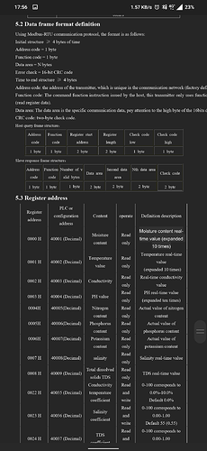

I see on that paet of the datasheet the register address on the left side.

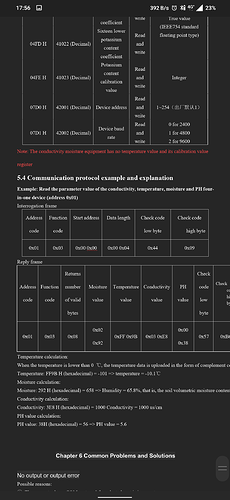

But the example later on that sheet confuses me (it's an example that shows 4 sensor at once working).
Thanks and with best regards
Device specifications:
The worked example is as I described back in post #95. Your sensor has a different register layout to the standard NPK sensor.
The example is telling the sensor to send 4 words starting from address 0000. Your image shows (left hand column) the addresses and you can see what parameters are held in registers 0000, 0001, 0002 & 0003.

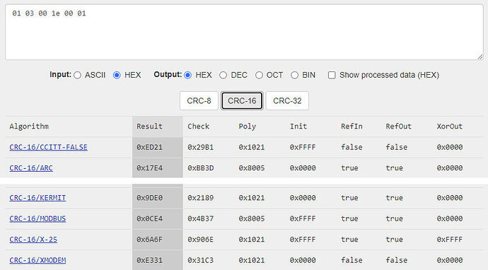

Yes, if you want the sensor to return 1 word from address 0x0000. To calculate the checksum, I recommend going to crccalc.com and selecting CRC16, entering your values and reading the modbus checksum it calculates for you.
EDIT: Here's an example of how to calculate the checksum using the nitro message:
const byte nitro[] = {0x01, 0x03, 0x00, 0x1e, 0x00, 0x01, 0xe4, 0x0c};
Go to crccalc.com, select HEX as the input and output. Type in the 6 bytes of the message and click on the CRC-16 button. The web page should look something like this:
Scroll down the page till you find the CRC-16/MODBUS line. Note the 16-bit value 0x0CE4 in the darker shaded box. That's the value you want.
Look at the canned nitro message and you can see the 0x0C and 0xE4 values - note that they are swapped around (lower byte first).
You can use this technique to calculate the Modbus CRC for any of your pre-defined messages you need.
