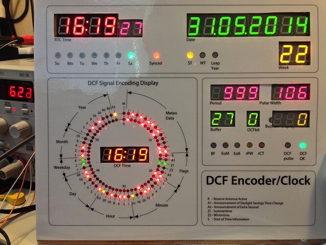

I also bought 10 Maxim 7219 chips but out of frustration I finally purchased some real ones.
For my DCF77 radio clock project, I used 8 Maxim chips in a daisy chain for the Common Cathode Displays and 1 Maxim for the Common Anode one.
But I noticed that at random, some displays showed strange characters. Also some LED's lit up very dim when they should be off.
I'm curious to see what happens when I use genuine Maxims when they arrive...
front panel text needs to be corrected but it's still a work in progress.
edr1924:
Seriously sweet project!
