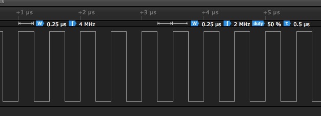

Was you able to do so? Due to the while() loop cycles, we can't get a perfect regular signal as far as I can see...
http://em10-usd-arduino-takahashi.eliotis.com/downloads/files/arduino_max_blink.zip
The best I can achieve is 4Mhz (taking care to while() cycles)…
http://em10-usd-arduino-takahashi.eliotis.com/downloads/files/arduino_perfect_max_blink.zip

Can we set CTC to 1? My analyzer do not catch anything. i need to use at least 2 -> 8Mhz (the answer of MarkT).
Might indeed be 2... Just did it from the top of my head. If I really need to do CTC stuff I always have to triple look at the datasheet ::slight_smile:
