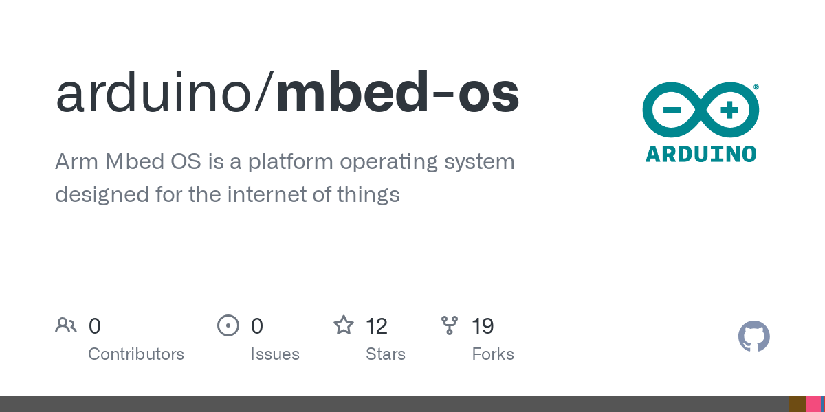

Hi @luci_codreanu.
For the most part. Arduino has applied some patches to Mbed OS:
They are mostly adding new targets for the Arduino boards. They would generally avoid making any changes to the Mbed OS API, and so don't affect the applicability of the documentation.
This, and add the mbed:: scoping operator to references to objects in the global Mbed OS namespace.
