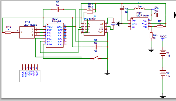

Hello there! I am making a small clock project. It being a simple little project, plus the fact I have completed 4 very similar ones, I decided to skip prototyping and design and etch my PCB right away. It is all good, until I start the MCP1640 regulator.
I am using a version that connects input to output when disabled (Vin=Vout). My plan is to disable everything and go to sleep mode, then, once woken up, turn on the regulator to get voltage to power leds directly from my micro (attiny84). However, once I turn it on, the voltage boosts up to 7, or even 8 volts. Everything else is disconnected apart from Arduino, which I use only to supply power (Vcc, GND connected, no other wires).
The setting resistors are pretty close to the recommended setup. 910k and 330k against recommended 976 and 309. In the datasheet it says that the highest output voltage is 5 volts. I have quadruple checked all connections, if it's not the wrong way around, etc. Continuity tests ok, capacitors are there, the inductor seems fine, plus I have used the exact one before and it worked just fine.

https://www.dropbox.com/s/yse93ajhexueha7/clockschematics.PNG
Here you go. This is the best schematic I could find. Edit: Whoops, this one is missing the enable pin. It's connected to my micro in fact, sorry about that, bummer. The values are arbitrary, I just made the schematic so that the layout process is easier. I have done minor changes since then, but that was only using different microcontroller pins for the sake of improved board layout and also connecting the programming header. However, it got a bit messy once I did that.
Hi, can you update your schematic to the values you are using, you have, Rbot and Rtop as 1K, but you say you used close to the specified values.
Also what is the value of the inductor the specs say between 2.2 and 10microHenries, your schematic shows 1milliHenry?
The other problem could be an earth loop on your PCB, or not big enough tracks to conduct the SMPS ripple.
What do you have EN connected to? You cannot leave it open.

thegoodhen: This is the best schematic I could find.
We don't want a schematic that you found, we want the schematic that you drew. You know, the one that corresponds exactly to your circuit.

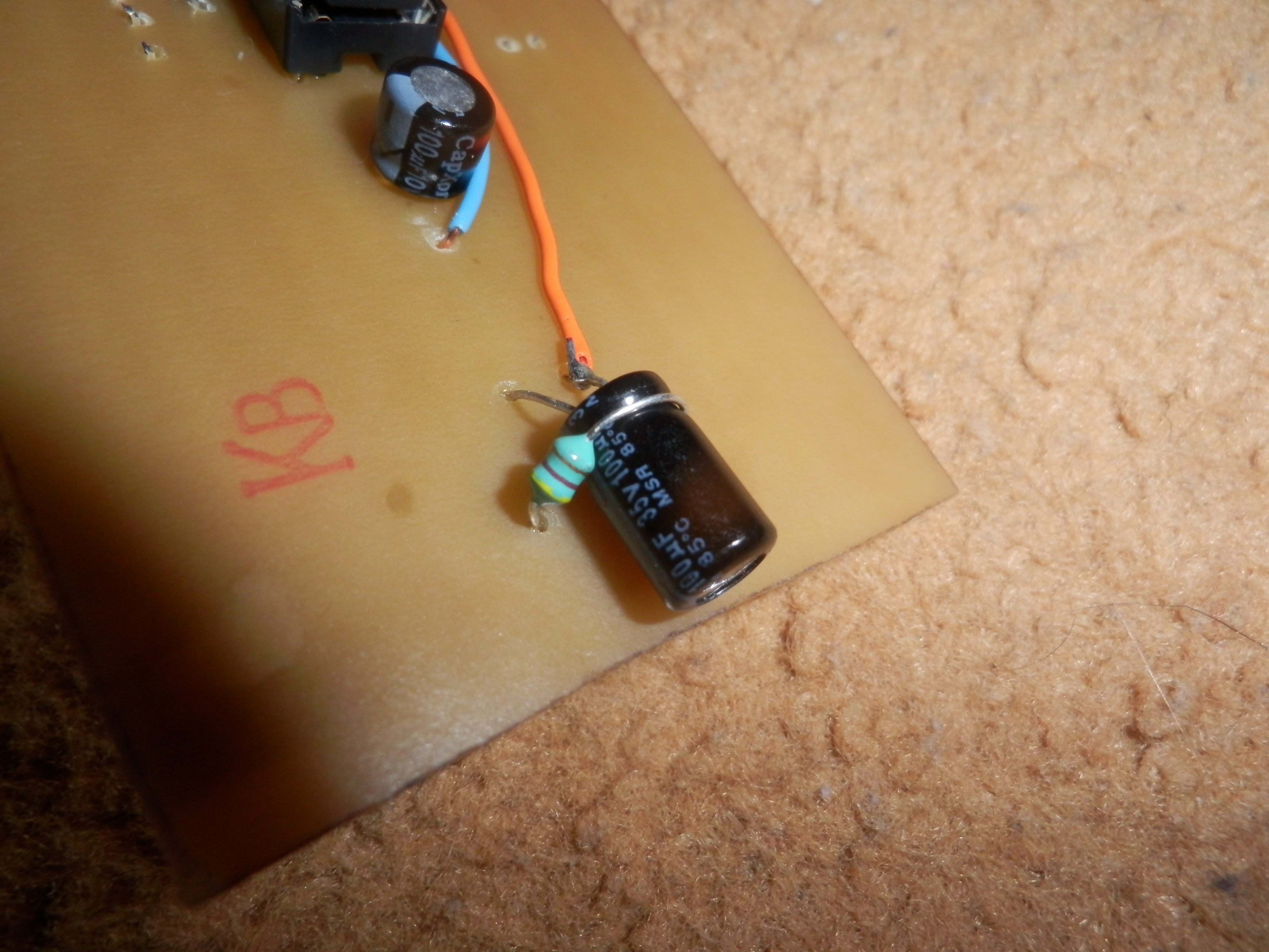

I've tried adding a 100n ceramic in parallel-no changes. I have also added 2 dummy load resistors. Each one improved it a bit, now We are looking at 110 ohm dummy+220 ohm led-and the voltage levels aren't exactly dangerous-but they still are pretty high. 5.5 with the led on, 5.8 with the led off. But that's like what-50mA flowing through there? Can't help but think I am doing a workaround instead of actually fixing it.
Edit: Do you think this could be a part of the issue? I wouldn't actually design it like that, not in my right mind, but ad-hoc, when I was soldering the stuff together, it seemed incredibly convenient... https://www.dropbox.com/s/ea0bc9qr67l7hiv/P6010173.JPG
Edit2: Oscilloscope confirms steady output ~6v, 0.1vpp noise
That is a lot of noise.

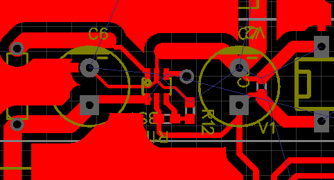

Those caps are miles away. The secret of a good PCB design is to have the components as close as possible if not closer. Many professional engineers fail to get it right first, second and even third time.
Also try adjusting that resistor divider to trim the voltage closer to what you want.

Hm... I tried to put them as close as possible given the footprints... https://www.dropbox.com/s/dmsj3lrprzcrlym/capsclose.PNG

Edit: Actually, I've just realised that if the components overlap, it doesn't matter since they are from a different side of the board. Didn't think that through.
