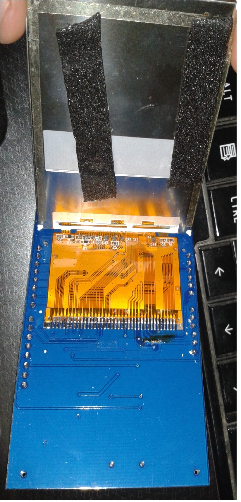

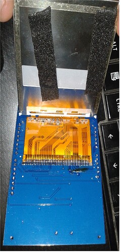

Hi every one .
I bought 2.8 TFT LCD Shield and i don't know how determined the type of Controller :frowning: .
I'm try use many more Library without any result :frowning: .
there is some library Loaded in Arduino , library from Adafruit-GFX , serial monitor find LCD Identifier is 139 ! !
Does this mean it's working but it's not realizes the type of controller ??
There is something caught my attention the shield does't have any ICs like all shield i see during my search !!
i attach photo to the LCD shield >
Can any one help me :slight_smile: ?
thanks
It looks like a apparently S6D0139.
