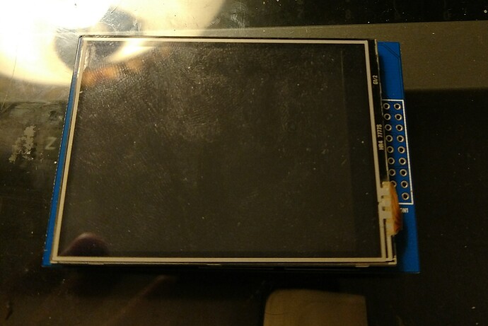

MCUfriend 2.8 TFT LCD Shield not working (with any libraries Ive found).
Using an Uno clone with an mcufriend 2.8" TFT LCD Shield. Tried a variety of different libraries (different ones people had modified as well as adafruits) with no success. Can anyone tell me what Im missing? Screen powers on with my uno, but just displays a white screen.
The back
Front
You have a regular Blue 2.8" Mcufriend Uno Shield.
Install/Update the MCUFRIEND_kbv library with the Library Manager.
Run the new "diagnose_TFT_support" sketch from the examples.
Copy-paste the Serial Terminal to your next message.
David.
Sorry, I ran the program but not sure what the serial terminal is or what to copy-paste. It successfully uploaded but the display is still white (as i imagine it should be), and no errors came up, but all the lower window says is

Oh awesome, thanks! Hmm. Says
Diagnose whether this controller is supported
There are FAQs in extras/mcufriend_how_to.txt
tft.readID() finds: ID = 0x4747
This ID is not supported

and when i run the LCD_ID_readreg it says
Read Registers on MCUFRIEND UNO shield
controllers either read as single 16-bit
e.g. the ID is at readReg(0)
or as a sequence of 8-bit values
in special locations (first is dummy)
reg(0x0000) 47 47	ID: ILI9320, ILI9325, ILI9335, ...

So you have a Himax HX8347-D controller.
Follow the advice in the screen message. i.e. read the how_to file
As it happens, your controller requires the exact SUPPORT_xxxx macro that is given as an example.
You just need to remove the two slash characters to turn a comment into a real statement.
David.

I thought that you had a HX8347-D
So the ID should be reported as 0x4747
Since you have a broken Touch Panel, there is no point in trying to calibrate it.
Can you see a crack in the glass?
Or perhaps one of the electrodes is not connecting to the resistive panel.
David.
Sorry, just a dumb mistake, one side of the pins just wasnt in all the way. But got the graphics test working now no problem. Thanks a lot!

Hi David, I have seemingly a similar problem that I try to describe the best I can as follows.
I purchase a 2.8" YFY display at:
I attached the photo of the PCB.
The drive is identified on the PCB as: ILI 9338
When running "diagnose_TFT_support.ino":
"Diagnose whether this controller is supported
tft.readID() finds: ID = 0xD3D3
MCUFRIEND_kbv version: 2.9.1
Probably a write-only Mega2560 Shield
Try to force ID = 0x9481
PORTRAIT is 320 x 480
Run the examples/graphictest_kbv sketch
All colours, text, directions, rotations, scrolls
should work. If there is a problem, make notes on paper
Post accurate description of problem to Forum
Or post a link to a video (or photos)
I rely on good information from remote users"
So I suspect the drive ID is NOT ILI9338 but D3D3?
I tried forcing ID to ID = 0x9481 but it did not work. Actually NONE of the MCUFRIEND_kbv example codes work.
I would much appreciate your help and advice.
From memory I did not publish the diagnose TFT Controller example until v2.9.8
You seem to have v2.9.1
Please can you run the LCD_ID_readreg example. Any version, any age should be ok. Copy-Paste from Serial Terminal to a code window in your message. (use </> icon )
I strongly recommend that you use an up to date library e.g. v2.9.8 from the IDE Library Manager.
If you have installed something manually, please leave IDE, delete library directory, restart IDE.
Then you can let the IDE Library Manager do its job properly i.e. install / update / downdate.
There is something strange going on. It is important to solve this. Thanks for posting a link. It helps when I can see which shop has sold the screen.
David.
