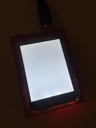

Hi, I bought a lcd touch display. It is a MCUFRIEND display (picture attached)
http://www.miniinthebox.com/da/diy-2-4-tft-lcd-touch-skaerm-skjold-udvidelseskort-til-arduino-uno_p2022293.html
I wanted to connect it to the Arduino Uno or Arduino Mega for some NeoPixel projects.
The problem is a can't seem to find the correct libraries to run this display and at first to display something...
But when I connect it to the board I just get a white screen and uploading a graphictest example the screen doesn't change at all and stays white. I got the touch screen to work and display the X and Y positions but nothing else.
Do you guys have some suggestions.
The images!

I suspect that your Red 2.4" Mcufriend Shield is 240x320 with a Himax HX8367-A controller.
I do not know of any existing Arduino library. I have never heard of this controller on a shield.
Please run the LCD_ID_readreg.ino sketch and post the output from the Serial Terminal.
If you are willing to do the testing, I will add conditional support to the MCUFRIEND_kbv library.
David.

Download and install a current Release of the MCUFRIEND_kbv library v2.9.3
You will need to enable the HX8347-I controller. I suggest that you disable SUPPORT_B509_7793 and SUPPORT_4535 if you are using a Uno.
MCUFRIEND_kbv.cpp:
#define SUPPORT_8347D             //HX8347-D, HX8347-G, HX8347-I +520 bytes, 0.27s
graphictest_kbv.ino: in the setup() function
    if (g_identifier == 0x00D3 || g_identifier == 0xD3D3) g_identifier = 0x9481; // write-only shield
    if (g_identifier == 0x6767) g_identifier = 0x9595; // force the HX8367-A to use HX8347-I ID
    tft.begin(g_identifier);
Run the graphictest_kbv sketch. The HX8367-A datasheet is very similar to the HX8347-I
If you are lucky, you might get a display.
Please make notes of anything that looks wrong. e.g. colours, directions, mirroring, ...
Then make a report back to the Forum.
David.
Thanks, got it working by using what you said!
You still need to study the sketch. i.e. does the Software Scroll work? does Invert work ?
Every single test should work 100% with a HX8347-I.
Does the display look happy? i.e. no shakes or blurring.
Remove the sticky label first. Everything looks horrible when the label is in the way.
David.

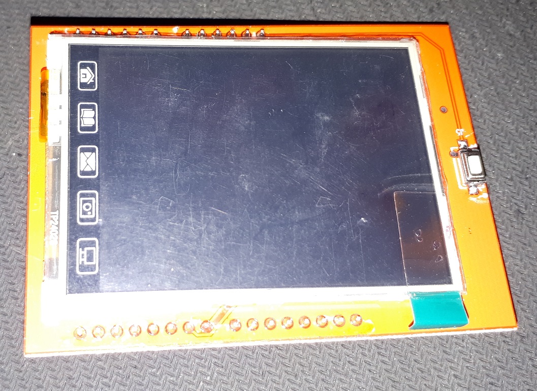

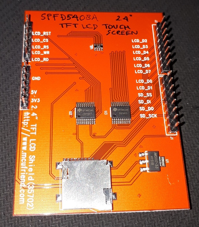

Please post a photo of the pcb. e.g. link to the actual Ebay sale or your own photo.
Is there any text written on pcb. e.g. OPEN-SMART or mcufriend ?
Install/Update library with Library Manager.
David.

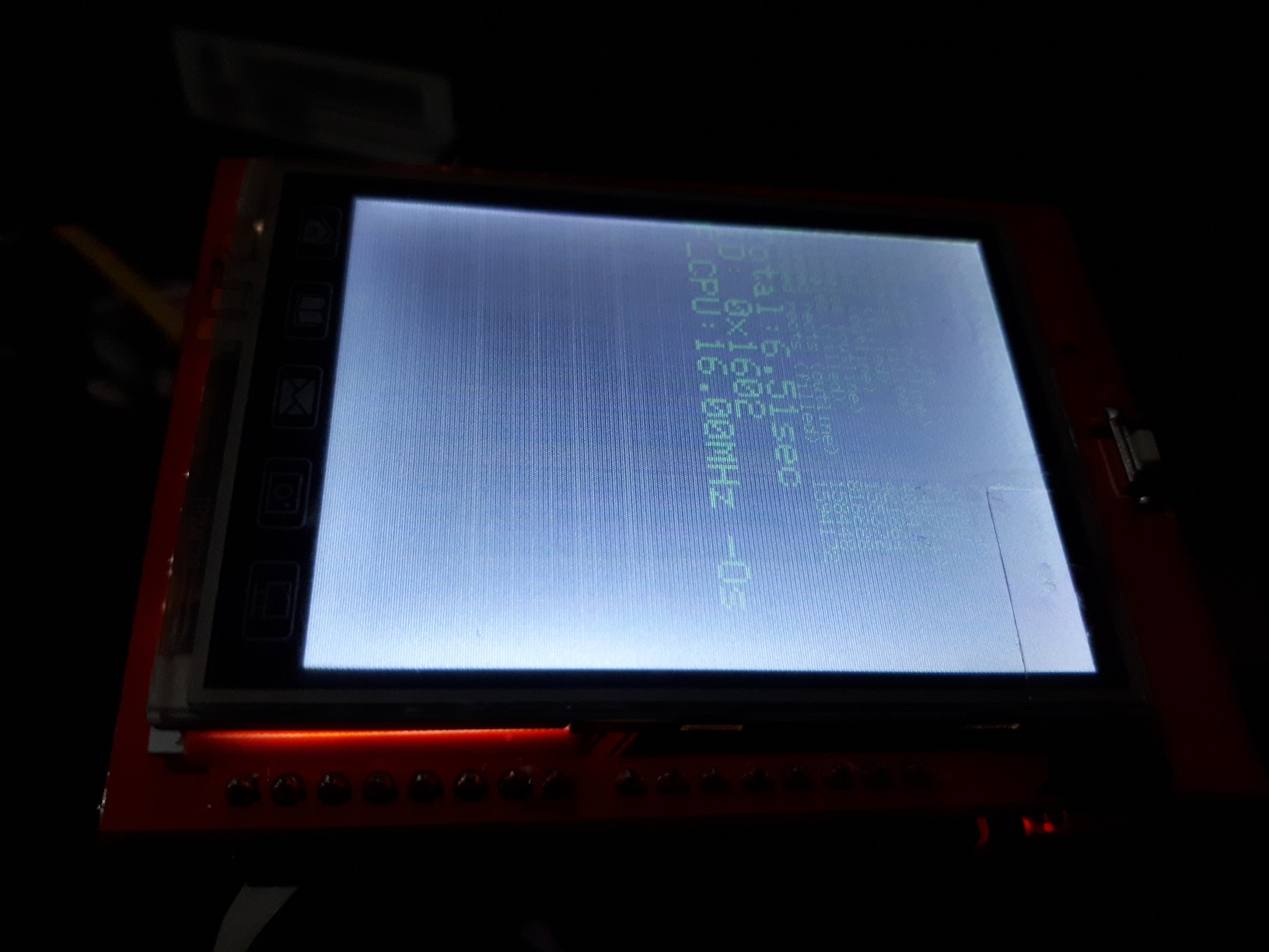

Hi David,
My lcd touch display with red color pcb is similar with tunstsk’s display.
I test graphictest.ino from Adafruit_GFX library with tft.begin(0x9341), it works but backlight noisy with some vertical lines, cannot full black color.
Try with other drivers cannot work at all.

Whereas output from graphictest_kbv are:
Serial took 0ms to start
ID = 0x1602
Could you suggest what proper driver should be used ?
tuntsk had a HX8367-A controller.
You have a "0x1602" display. I have never seen this display. I do not know the Manufacturer.
I do not have a datasheet.
Have you asked the Vendor for help? Have you asked for a refund or replacement?
Yes, your photos look exactly the same. The Power and VCOM settings need tweaking.
What country are you in?
David.
Hi David,
I am from Indonesia.
I bought it long time ago from local store so I forget which store, just today I tested it after I found this thread.
If this cannot be solved, maybe I need to buy new one.
These attachments are for the detail pictures.
