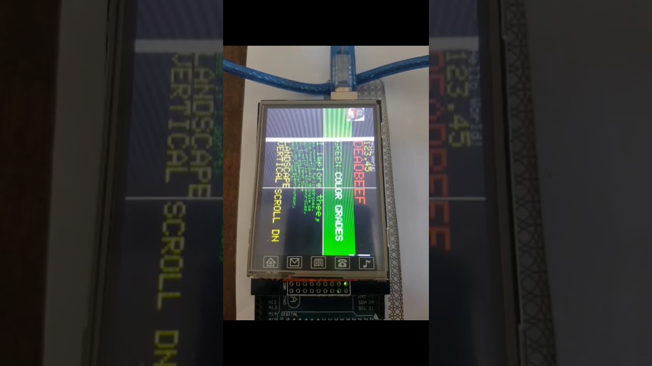

Fixed the scrolls problem by moving back the "tft.WriteCmdData(0x07, 0x0237); //VLE1=1, REV" line inside the scroll_0139_band function.
Please show the working scroll_0139_band() function.
Did you get different Band scrolling?
Or just the whole screen?
David.
Here : mcufriend 0x0139 v9 - YouTube
Thanks for the video. The scroll is not a proper Band scroll. It simply scrolls the whole screen with a Partial window.
Partial Screens are fairly useless feature of most TFT controllers.
The ILI9320 style supports two Partial windows that you can move around the screen.
ST7781 has two Partial Windows in theory but does not work properly.
ST7781 hardware actually has Vertical Scroll but it is broken. Hence no mention in the datasheet.
S6D0139 has two Partial Windows but no ability to move around the screen.
Most MIPI controllers e.g. ILI9341 have a single Partial screen but no ability to move around the screen
I have amended test_0139 on GitHub. Please try the regular graphictest_kbv example.
You should see whole screen scroll. The "Band scroll" should move the whole screen too. i.e. like a ILI9320
David.
Whole screen scroll works, band scroll works on software scroll if I saw it correctly.
No, I messed up the scan lines. Did you not notice the white band in the vertical scroll?
I have restored my initial NL code. Merged the S6D0139 changes into the master Branch (beta). Removed the test_0139 Branch.
The changes will be in the forthcoming Release. You will need to enable the SUPPORT_0139 macro in the Release.
David.
Yes I saw the white line but I didn't know if it was expected of not.
Thanks a lot for all the hard work you've put into this. It's really appreciated :slight_smile:
