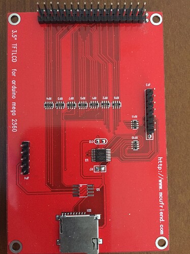

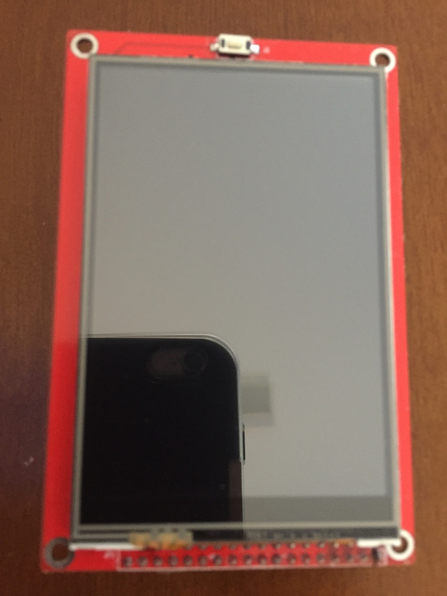

This is the issue I am experiencing with this screen:
MCUFRIEND 3.5" TFT LCD for arduino mega 2560
working with UTFT driver(s) using either ILI9486 or R61581 all OK.
The issue I have, on initial Power up, the screen may or may NOT display any information.
Remove power, or disconnect once or twice and it comes on in perfect working order!
Also once it is running it will run for many days without any issues.
The sole problem is the initial start up.
I have tried to see anything obvious with the driver(s) initialization code but that in NOT
an area with any knowledge at all, so I dare NOT make any changes.
Any suggestions will be gratefully welcomed.
Attached are pix of module.
It looks like a regular Red Mcufriend Mega Shield with 16-bit parallel interface.
These shields are write-only. You have no way to read the ID to see what controller is mounted.
The Ilitek ILI9486 and the Renesas R61581 are very different controllers.
Personally, I would run some diagnostic tests that might determine which controller you have.
Then you can use the appropriate init sequence.
The "user" commands are the same for any MIPI controller. But the "manufacturer" commands (as used in init sequence) are different for for each model and make.
