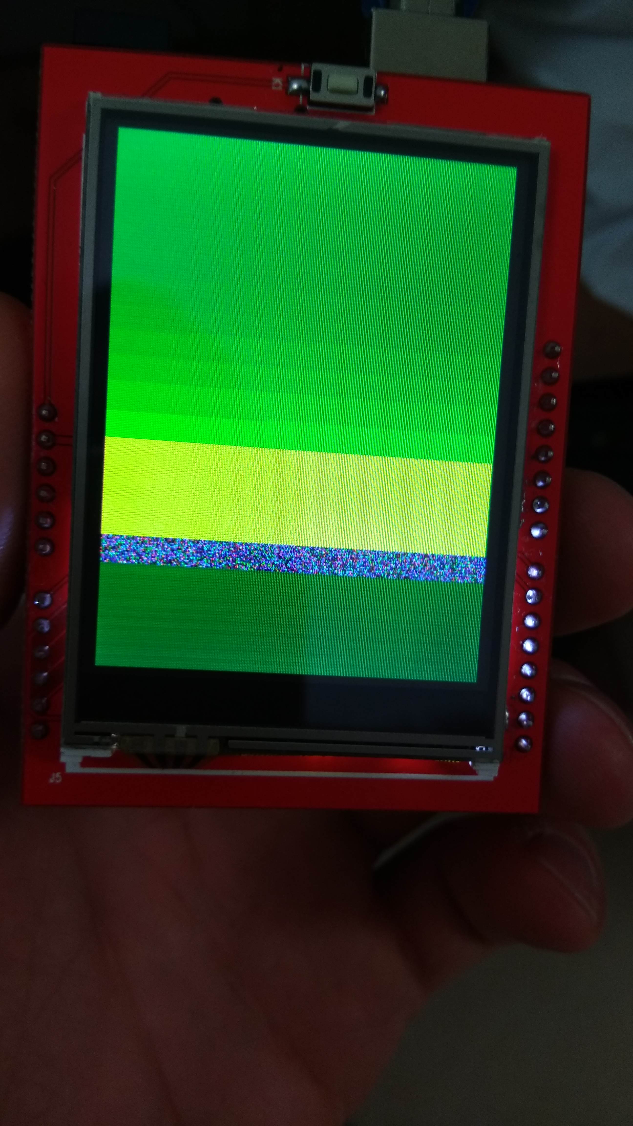

Hello friends i order two 2.4 tft shields from AliExpress and a i have some problem. I figure out that 8347 driver is used in them. When i run test examples the screen shows some distorted images

Done before. The result distorted image.
