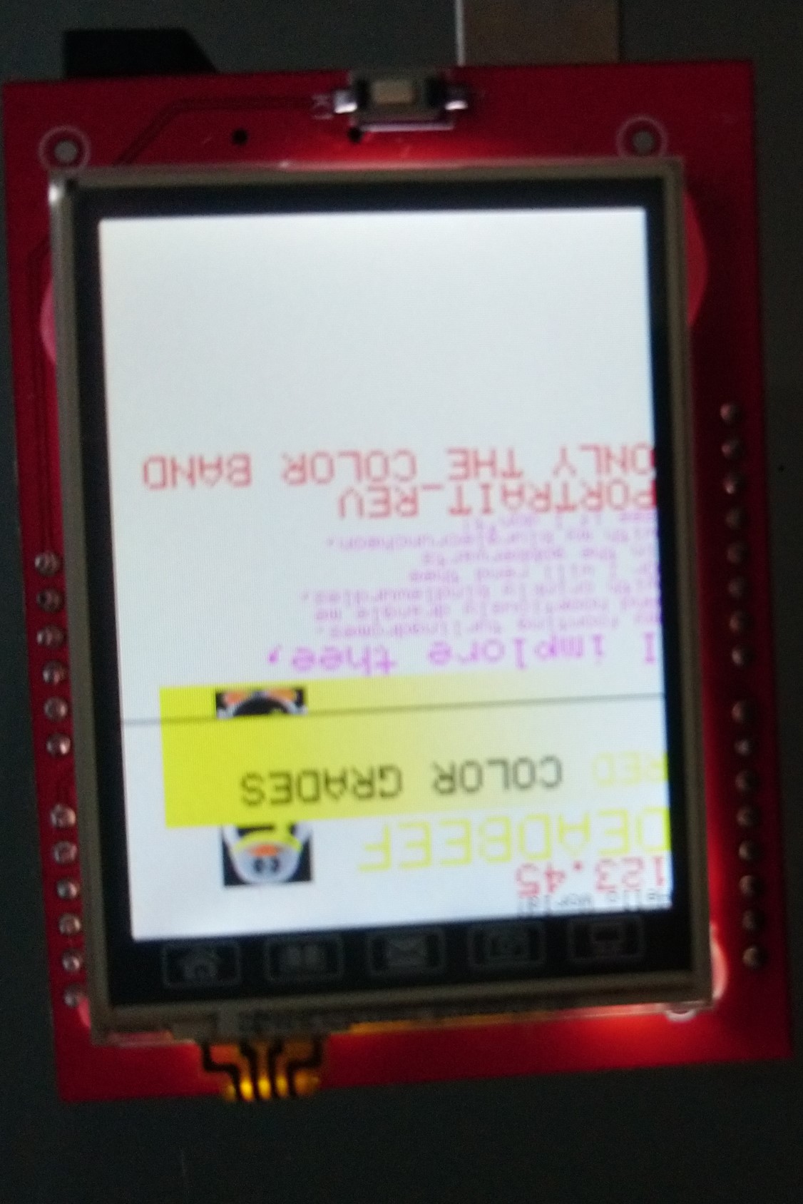

With this information and the information about the touchscreen I tried several ID hardcoded to get the screen to work. Most of the HX8357 id provides output, but ID ILI9341 240x320 ID=0x9341 seems to provide best results.
When running graphictest_kvb I hardcoded the id to 0x9341 and compared the results to a correct 0x9341 display I ordered in the past.
For the new display I noted the following differences :
  • The screen was flipped over the short axis.
  • Blue and Red where swapped.
Can someone help how to get this display functioning correct?

Meanwhile, I suggest that you use tft.begin(0x9329) and report the result of the 4 Penguin screens.
Either as photos or describe any problems e.g. colours, rotations, scroll directions, ...
David.

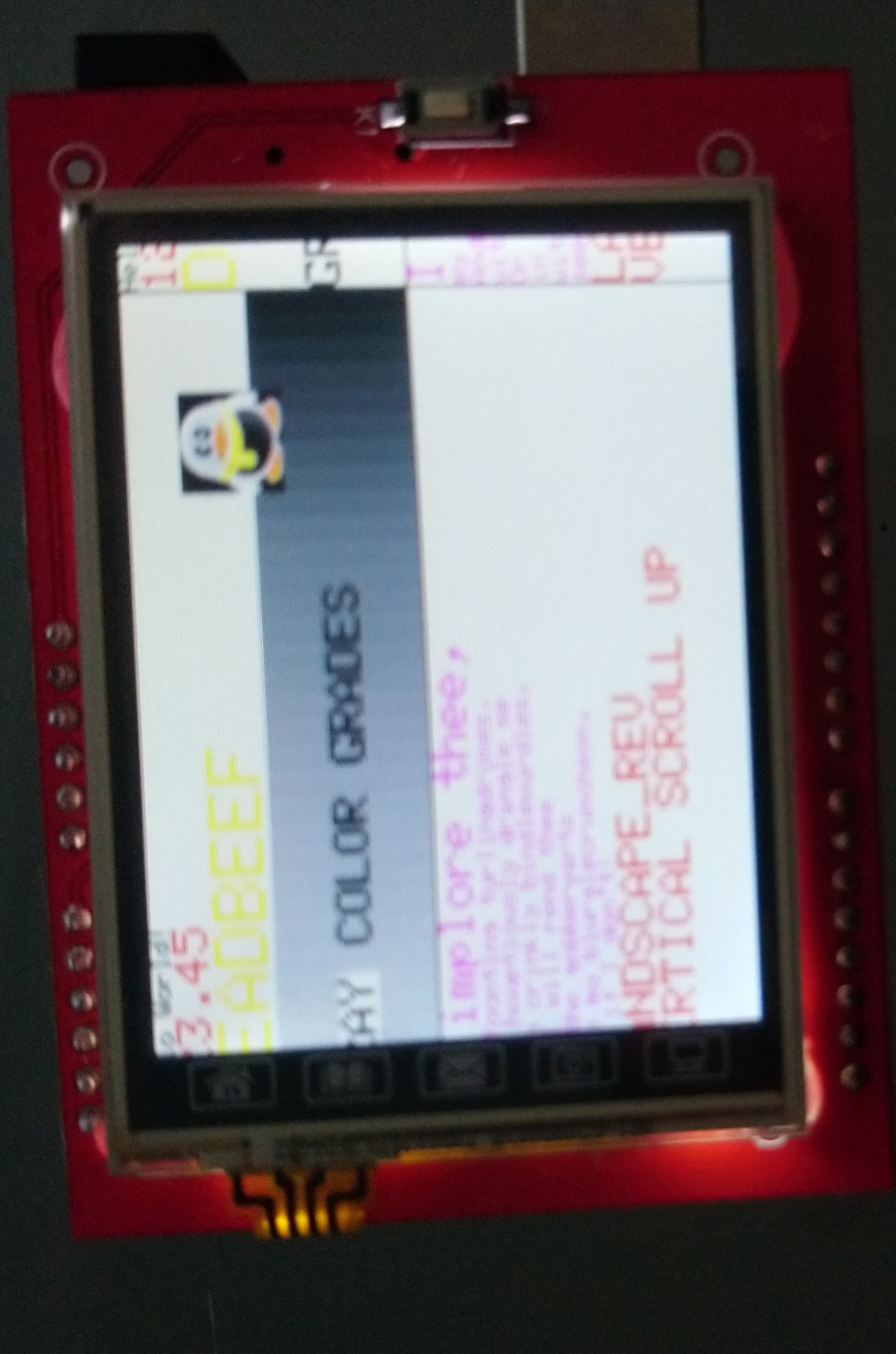

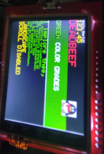

I have updated graphictest_kbv with
tft.begin(0x9329);
I've attached the 4 penguin screens to this post.
Full movie is available at MOV 0402 - YouTube

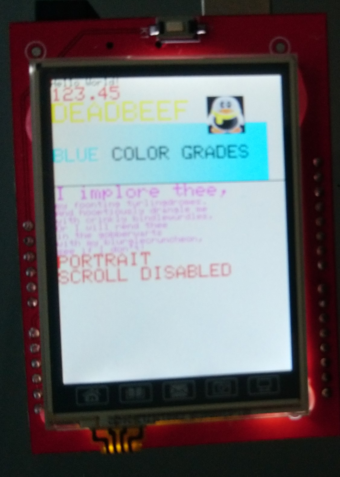

Search for this sequence in MCUFRIEND_kbv.cpp
    case 0x2053:    //weird from BangGood
        _lcd_capable = AUTO_READINC | MIPI_DCS_REV1 | MV_AXIS | READ_24BITS | REV_SCREEN | READ_BGR;
 goto common_9329;
and add a new begin() case i.e.
    case 0xE300:    //weird from BangGood
        _lcd_capable = AUTO_READINC | MIPI_DCS_REV1 | MV_AXIS | READ_24BITS | INVERT_SS | INVERT_RGB;
 goto common_9329;
 goto common_9329;
and in readID() search for readReg32(0x04); and add new line like this:
    uint32_t ret32 = readReg32(0x04);
    msb = ret32 >> 16;
    ret = ret32;
    if (msb = 0xE3 && ret == 0x0000) return 0xE300; //reg(04) = [xx E3 00 00] BangGood
This should read ID as 0xE300 and fix all the "problems" but the colours in Penguin screen might not be perfectly smooth gradation.
David.
Edit. I have corrected the INVERT_RGB attribute
With the changes the ID is now detected as 0xE300
The text directions are now correct.
Als scrolling up / down is correct.
Only Red And Blue color are swapped I think.
When the Penguin screen states BLUE Color Grades, the bar is Red.
Oops. You need to swap Red and Blue:
 goto common_9329;
Please check that Software Scroll still works.
David.
Thank you for the fix. The Graphics test now looks ok :).
Also Software Scroll works.
I will update the topic as soon as I receive info from banggood about the hardware specs.
I look forward to hearing their reply.
David.

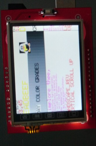

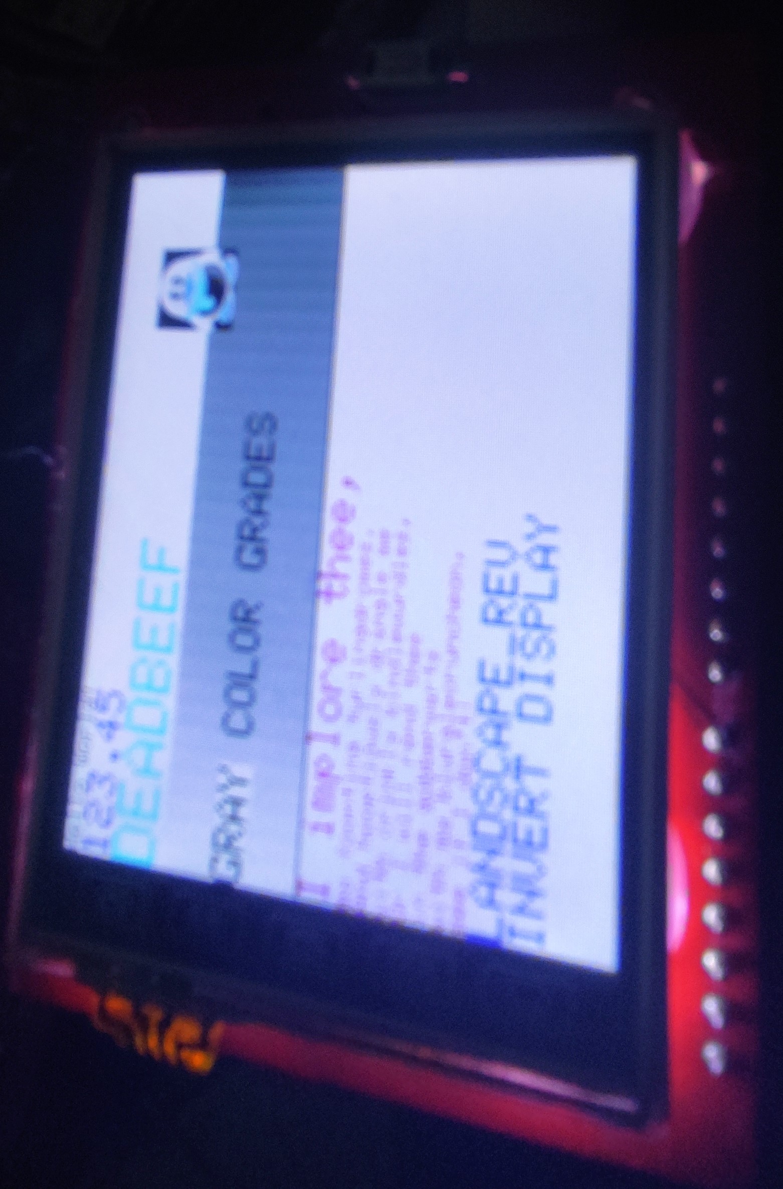

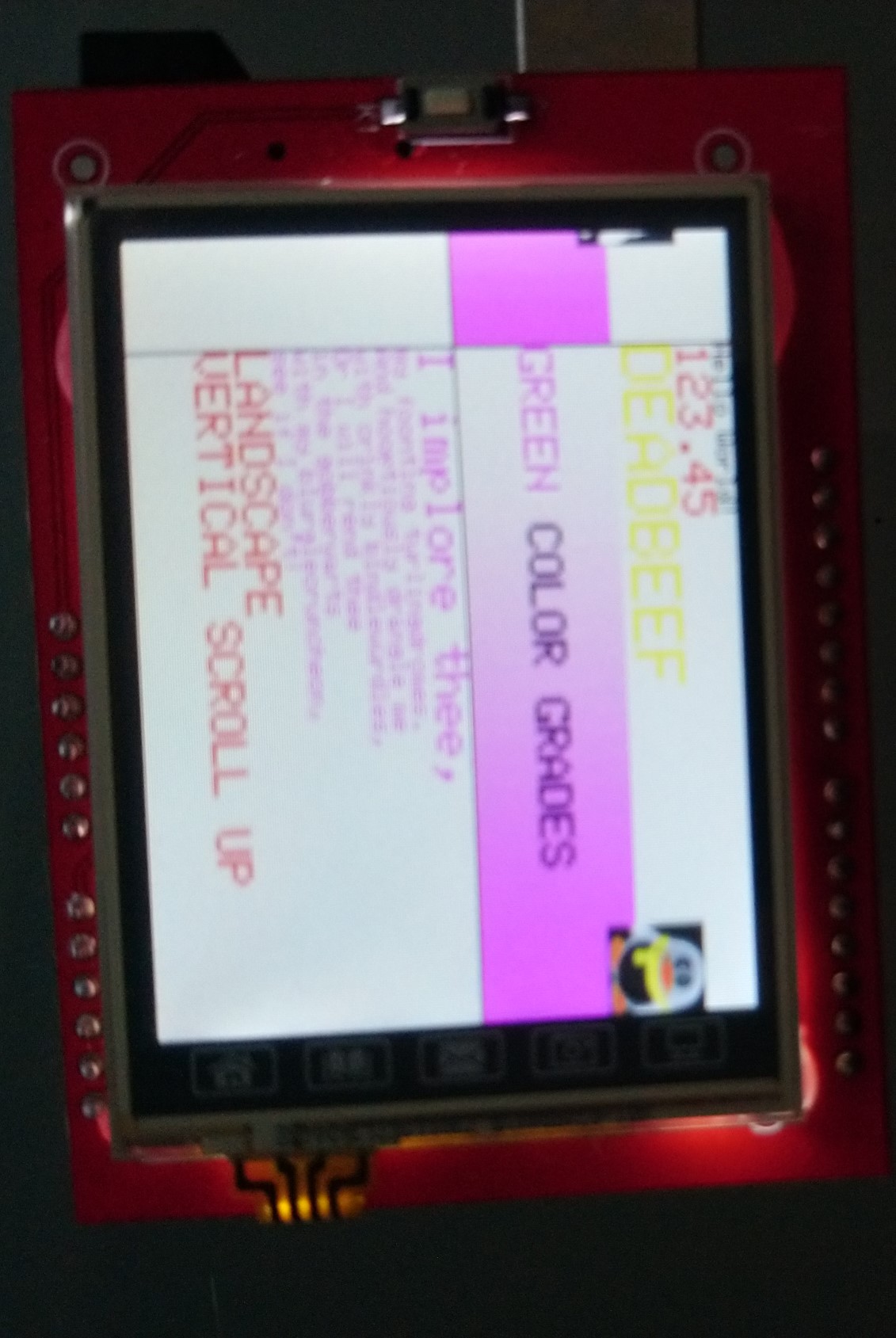

Hi
Thanks for quick reply. I have purchased it from my local market and he don't know the IC detail. he is saying that it might be 9134, but that is not the case.
Anyway I have tried #3 and I am attaching the images of result. I think is working better but the very last screen it again gets colors inverted . Please check and guide me.
thanks for your guidance

Your three JPG were all correct colours and rotations.
Did you need to add REV_SCREEN to #3 ?
David.
yes the colors seems good to me. No I have just followed the #3 . Didn't include the rev screen
