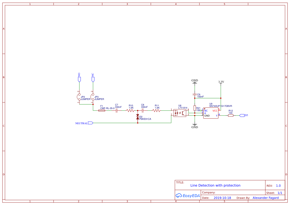

Ideally, I need to reliably measure a really small amount of AC current approximately 50-70mA. However if that isn't feasible, simply detecting whether or not a 50-70mA source is on will suffice.
The source is a irrigation solenoid (I need to determine when it is on to update my log as to when it was last on).

L1 is the solenoid. R1 may not be needed. Put the bridge across the solenoid to make sure it still activates without R1 C1 smooths the output of the bridge or else you could be seeing a square-wave output from the opto-coupler. Use a 47uF Electrolytic. R2 is needed to protect the LED in the opto-coupler.
Configure the GPIO to INPUT_PULLUP, or better, use an external pullup of 10K.
When the solenoid is energised, measure the DC voltage on C1 to calculate the value of R2 you need to protect the diode.
GPIO will be low when the solenoid is energised and high when not.

Construct a ~1.5volt power zener with three 1N4004 diodes.
Two in series, and one reversed in parallel to the two.
That ~1.5volt peak voltage could drive an opto LED via a 47ohm resisor.
The opto transistor goes between Arduino pin and ground, with internal pull up on the pin.
Bridge zero-crossings in software, or add a cap across the opto transistor.

Why not use an optocoupler across the valve solenoid?
A small bridge rectifier between the solenoid coil and the opto to provide DC feed.
The advantage would be the Arduino would be isolated form the inductive circuit of the solenoid control circuit.
Tom...
That in conjunction with Steve's diagram as well as Wawa's tips gives me a great starting point! Thanks guys

So you did go for voltage detection, not current detection.
R2 can be removed. Use internal pull up on the pin instead.
pinMode(detectorPin, INPUT_PULLUP);
Leo..

390k (R1) could be too high. Start with 100k, and see if the Arduino pin gets LOW.
Leo..
Please note, your frontend doesn't have to be this complex. It can also be just use two resistors - one on the live and one on the neutral of 100k each, or you can have a frontend similar to what Wawa described using diodes however using that method your circuit would have to be in series with either the neutral or live wires.
The Schmidt trigger buffer is entirely optional but I found it does a really great job of smoothing the output and making zero-crossings easily detectable.
Nope. This was just in response to where the thread went with straight line detection. As you are aware given that you were active in my other post, I've got both line detection and ac current detection. However, I added the circuit for the current part as well here (anyone interested, the code is available in the linked post).
I use the line detection to determine if current even needs to be measured at low currents given that the current sensor output varies a bit when no load is present.
wvmarle:
Using capacitors instead of resistors is a good idea: saves dealing with the heat.
Do make sure you have appropriately rated capacitors, preferably X rated safety capacitors.
I've got 230 volt caps, but the whole circuit is protected by a ptc and a tvs so it should be fine. Even if one cap fails, there is redundancy in this setup.
