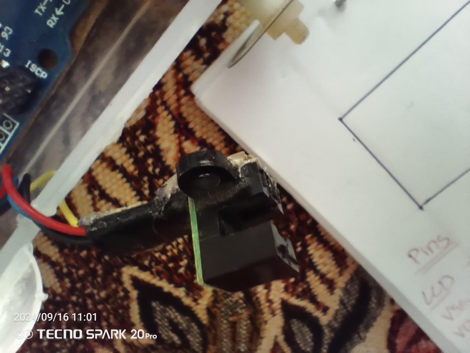

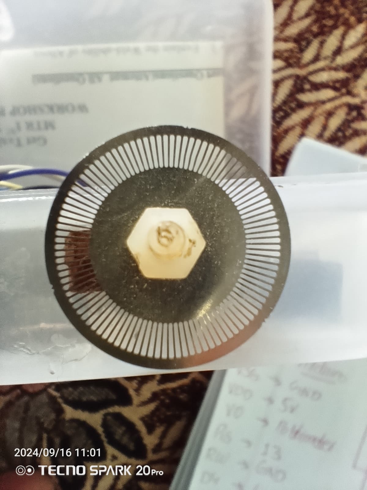

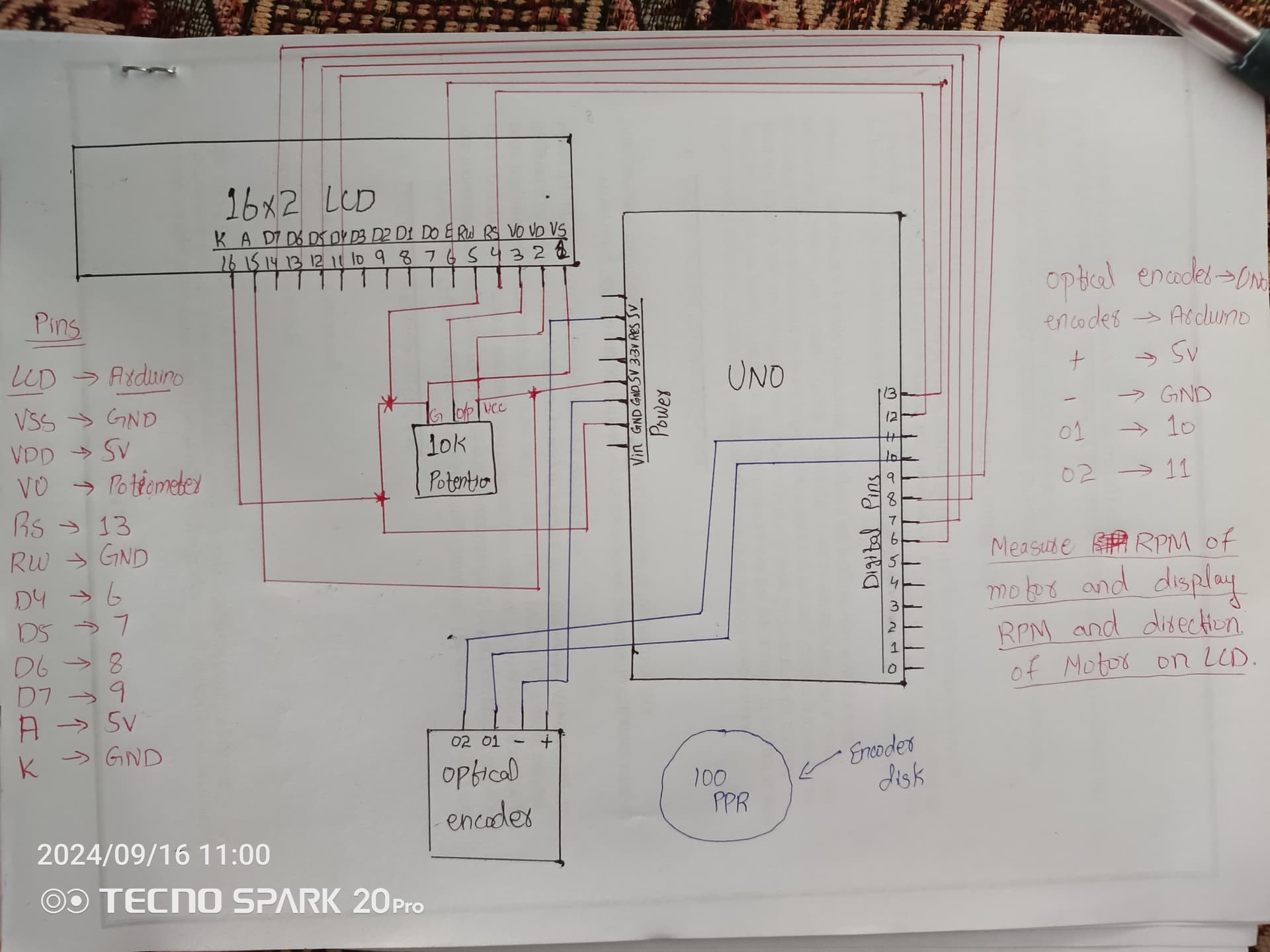

I have built this circuit. I have a small DC motor and encoder disk is attached to it. I need a program so the RPM and Direction of rotation will display on 16x2 LCD display. The circuit diagram and original pictures are here.
Please Can anyone write a program for me.
I will be very thankful to you.
I need a program for Arduino Uno to measure the speed of motor in RPM and direction of rotation using this optical encoder.

Good work on drawing a schematic of your circuit. However, I would recommend that you connect the encoder to pins 2, 3. These 2 pins alone on Uno have a special function that will be important.

Were you born with the ability to draw schematics and build circuits? No, I suspect you have learned that. If you can learn that, you can learn to program.

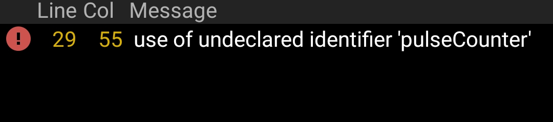

I have write this code but there is an error and I am unable to resolve this after 3 attempts.
What did you try in each of these 3 attempts?
The error is strange. Normally the IDE creates forward declarations for functions so that it is not necessary to declare a function before it is used. I know there are limitations to what types of functions the IDE can do this for (variadic functions, for example) but I don't see anything like that here.
Try moving the definition of pulseCounter() to before setup().
WOW :exploding_head:, Thanks :+1:, the issue is solved.
