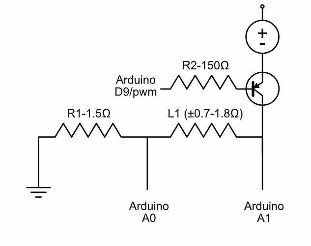

Thanks for the replies. I made a small drawing of what i'm trying to accomplish.
The measuring of the coil isn't the problem the powering accordingly confuses me (red lines).
I know this isn't going to work but how can you measure the coil and power it in the same schema (doesn't have to be at the same time. (I usually do not draw schemas so I may have used the wrong symbols) and maybe add some diodes to direct the current.
Why are you drawing an inductor for a heating coil? Its basically resistance, the inductance will
be completely negligible.
Lose the red ground connection, its shorting out your resistor.
Where is your base resistor for the transistor? You'll burn out the D9 and the transistor as you've
drawn it. 150 ohms is a suitable value.
What are the diodes for? - you need to lose both of them and you'll have a plausible circuit.
Take both sides of the heater to separate analog pins then you can accurately measure the
voltage across it, the transistor is unlikely to saturate fully.
Hi MarkT,
Thanks for your reply, I've changed the schema but are left with a few questions.
MarkT:
Doesn't the resistor R1 block/resist the flow from the coil? And wouldn't it heat up just like the coil does?

Isn't it a problem that when I supply voltage to the coil it could damage the Arduino/A0 pin As it could reach about 5Amp? Or does the current automatically chooses the shortest way to ground?
Peter
Any particular reason for high side switching of the heating element?
Also instead of a PNP transistor you should use a MOSFET, preferably n-channel for lower on resistance. You're not going to succeed switching 5A with a PNP (you'd at least need a darlington for this, as the Arduino can never supply enough base current, and that's not recommended due to the high losses). You're better off using a MOSFET, and low side switching.
This is my take on the problem:
To sense the resistance of the coil: bring SENSE high, Q1 switches on, and you can measure the voltage on SENSE_SIGNAL. Heating coil R1 and resistor R2 form a voltage divider, so you can easily calculate the resistance of R1. 10Ω limits the current to 500 mA if powering by 5V. You only need to have this on for a few milliseconds, just enough for the measurement, so indeed R2 can be a standard 1/4W resistor.
Then when the coil checks out, bring HEAT high, Q2 switches on and you have the full current for normal heating.

@wvmarle, Thanks for your solution, this does exactly what I want and I ordered the parts...
thanks again!
