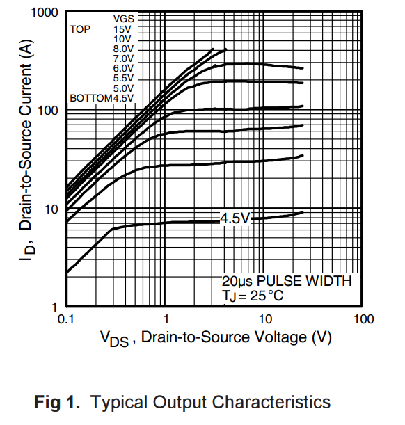

  • I'm plan to use smth like IRF3205PBF as Q2. It has small Rds (8mOhms drain-source resistance) but it still would affect accuracy because it will create another voltage devider with R1 + I use analogwrite for PWM generatipn on HEAT, so i cant time when its open/closed. Is there any way around it or should i just filter values in code somehow?
The IRF30205 looks good on the surface but you are only putting 4.7 volts on the gate. Figure 1 suggests the max current you can attain ~2 amp with a 0.1V drop. Its likely better that this but you will only get to the 0.008 ohms with 10V on the gate and the MosFet internal die at 25 °C.

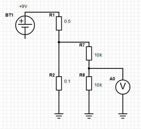

If I'm correct when there is no flow though Q1&Q2 voltage divider scheme for A0 should look like that:
9В_в1
And its formula:
Formula1
~1/2 of 9V in total
When Q1 opens scheme would look like this:
9В_в2
First of all formula for getting voltage on R78:
With R2 = 0.1Ohm (to get <1.1V for internal reference) voltage on R78 = ~1.5V
And then R7&R8 simply devide it by half and we get ~0.75V to A0.
Now all is left is to find EXACT resistors ratings.
Or am I screwd up somewhere? :grimacing:
No, you are not screwed up. You are right on track.
To help I did this: (if I could post an excel / libracalc file you could have it)
Impressive, but R1+10°C in my case would be 0.501, otherwise i had the same numbers. Now I understand how it all works and the weakest part is the components themselves (+/- 5% for resistors could influence measurements a lot, couldtn't find any precision ones available + they are low-power ones + couldn't find their TCR).
Any ideas how to improve accuracy other then measuring via arduino and comparing with the real values to calibrate calculations?
Metal film resistors (recommended over 5% carbon film) are usually 50 to 100 ppm.
I think you can get away with an R2 of 10 watts or so if I understand you plan correctly. Measuring the resistance of R1 will only take a few milliseconds not much time for heat to spread.
