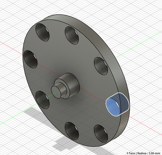

so the main thing is 50mm based off the measurements of the optical reader(https://europe1.discourse-cdn.com/arduino/original/4X/d/0/c/d0cf3e478a539b2b18514251b2110631ac20ce11.jpeg) above I was able to make this in fusion360.
There is room to double up on the holes between spaces. Would this give more accurate speed reading?

If the speed is changing between two holes, yes. Otherwise no.

I intended thickness of the wheel, to physically fit into that sensor....
That was assumed.
Office stores will print black on transparency pretty cheap, but cutting it out and mounting just so matters. Concentric rings could have different numbers of holes even.
Transparency is thin though the diameter could be wide.
