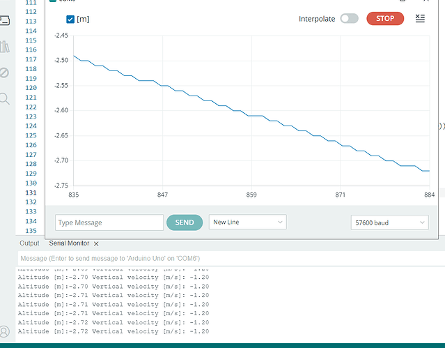

Hello all, thanks to Carbon Aeronautics, I converted his code (episode 19, using 2d Kalman filter to get altitude and vertical velocity) into a code that uses 2d kalman filter, but using MS5611 in GY86, not BMP280. The results however is very bad, I couldn't reach those 2 values around 0, the integral summing is so bad the plot is a straight down line, and when I lift the GY86 up, no more results show. I am using Arduino Uno and GY86. The third problem is that after plugging in the Arduino, it takes a very long time, about 20 30 seconds to start showing results. I tried changing the standard deviation but there is no luck:

  Serial.print("Altitude [m]:");
  Serial.print(AltitudeKalman/100);
  Serial.print(" Vertical velocity [m/s]:");
  Serial.println(VelocityVerticalKalman/100);
  while (micros() - LoopTimer < 4000);
  LoopTimer=micros();
Here is the result:
Thank you
