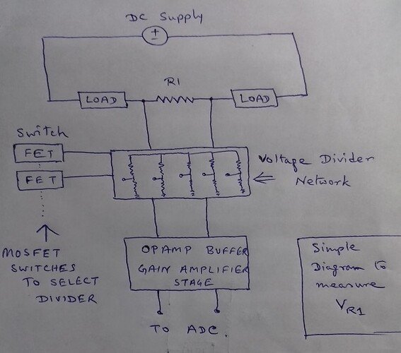

Hey, here is a simple diagram to show "what it is now" vs "what I want" in the design.
I used the x81 factor divider considering the full 400V, even if the whole drop happens across R1 (which will never be the case) the ADC will get <5V in its input.
But it is a problem when the voltage drop is less(eg 0.4V). So now I am thinking of using different resistor pairs as dividers and use mosfets(or simillar) to switch them from highest to significant lowest as in autorange systems to measure VR1.
But doing this may have an effect in accuracy, not sure how much? In kelvin connections the wire resistance doesn't matter - can I use something like that here?
Also if this design could work, I will need help in the gain / filter / amplifier stages.
Please check the attachments and give response.
Thanks.
Edit: I don't mind if my design is totally bad or is not suitable for this purpose. So don't try to go through this design and make it work somehow. If I get any idea that will work better, like Allan sir suggested, the complete analog devices sitting at the high voltage levels, i can go through that as well. I just don't like to work on high voltages, that's probably why I considered dividing and then amplifying to get to the results. Please see how it can be done. Thanks again.

I detect not only the moving but abduction to another playing field of your goalposts.
Neither of those diagrams resemble yours in post #32, to which I've been working, and which you have insisted is immutable.
Your design still won't work, but before I put any more effort into it, confirm that this topology is final. Your lack of understanding of why it can't work does not not bode well.
In particluar , why does your resistor to be measured (R1) have to sit between two other resistors?
Why can't one end be earthed?
And why can't I put a simple current source into it and dispose of your 'load' resistors? ( which dissipate a lot of power to no obvious purpose..)
If you made it clear what you're actually trying to measure, and the essential electrical conditions under which it must operate ( and perhaps why) I might find a neat answer.
Having been given only partial information I and others may well have been on a timewasting wild goose chase.

I think all the confusion is coz I hijacked this thread from another op whose problem is similar but a slight different than mine. I am gonna start a new thread now. Allan sir, please check your pm. The last shared drawing is quite near to the solution I was thinking. only the 0.5Ohm shunt to be inserted anywhere in the loop.
Edit: New topic posted here Measuring Low Ohm with micro-volt resolution precisely - General Electronics - Arduino Forum
