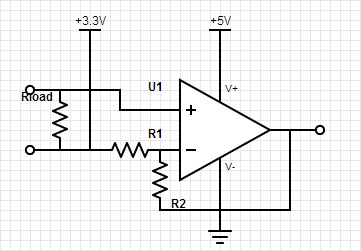

I didn't really understand the bandwidth thing. Does it matter if I'm measuring DC current?
I tried searching for current sense amps but couldn't find any available from the local supplier. But I found LT1167 instrumentation amp there. http://www.stanford.edu/class/ee122/Parts_Info/datasheets/LT1167.pdf
One thing in a datasheet is bothering me:
Single Supply Operation
For single supply operation, the REF pin can be at the same
potential as the negative supply (Pin 4) provided the
output of the instrumentation amplifier remains inside the
specified operating range and that one of the inputs is at
least 2.5V above ground.
Would it work If I pull one of the inputs above 2.5v with two resistors between ground and 5v?
I don't think you are going to find an adequate solution for your problem with an op-amp or an IA unless you gain a LOT more electronics knowledge... that being said an Allegro Hall effect device for measuring... Look at an ACS712... Link: http://www.allegromicro.com/en/Products/Current-Sensor-ICs/Zero-To-Fifty-Amp-Integrated-Conductor-Sensor-ICs.aspx
A simple device to use but it's output is centered at Vcc/2 and changes amplitude and polarity (+ Vcc/2 or -Vcc/2) depending on current flow and direction.
Diagrams of opamps to form level shifters should be within your search capacity. I personally would first try an LMC662.
R/R I/O, Low voltage and a low input current and low IOS. if required the second amp can be used as a gain block to scale the output of the level shifter.. A pot can be used to set the level shifter output to zero for zero current and the second amp can set the gain to something usable, If required.
The device is nearly foolproof to use BUT DO read the data sheet until you understand it completely BEFORE you begin.
