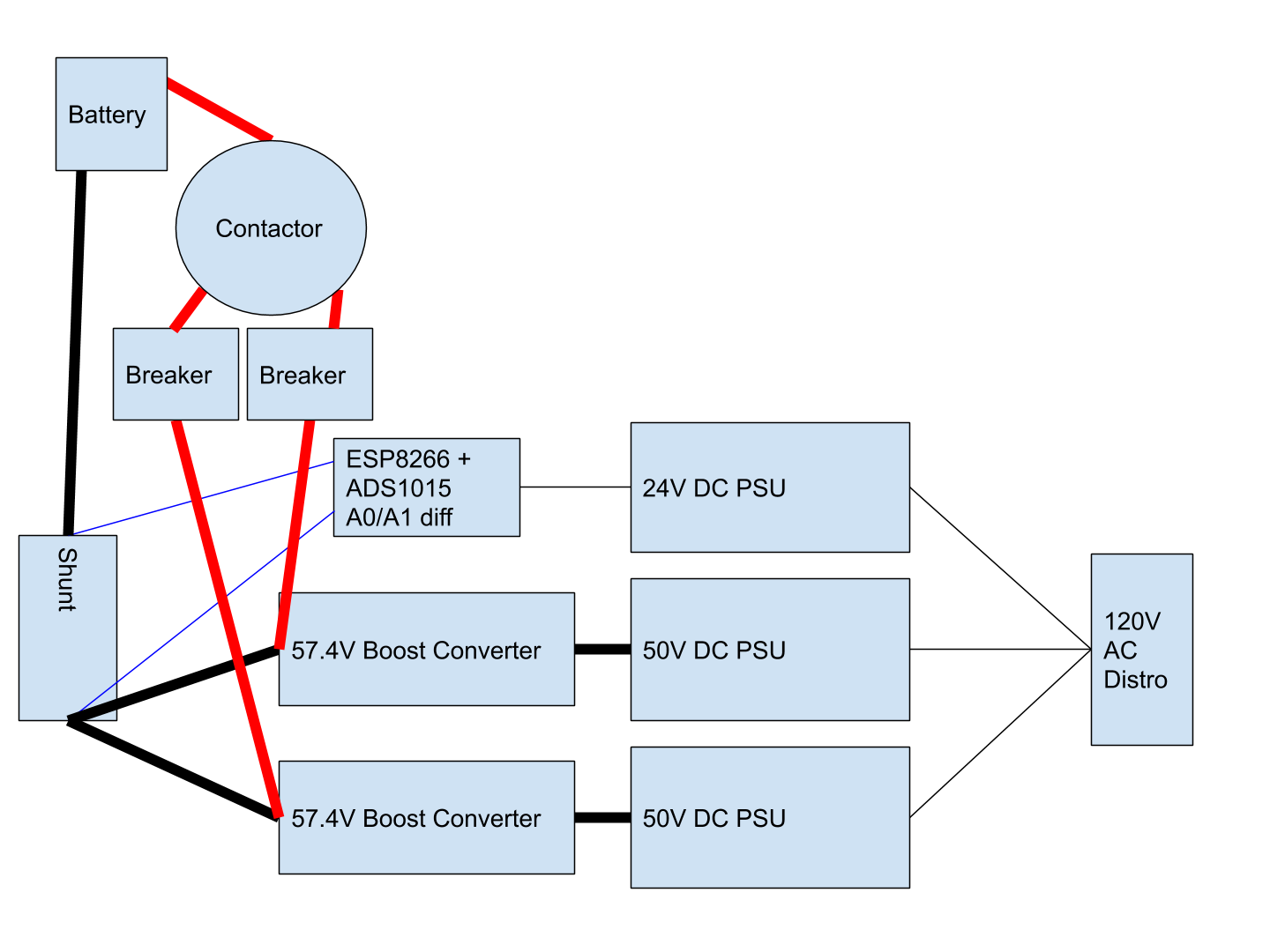

This is a battery charger I am building so I am measuring unidirectional current out of the charger. Can you give me more detail on the voltage divider you mentioned? Where should it go exactly? The ADS1015 board I am using has an adjustable gain, which I have set to 16X right now, so that should be enough to measure the shunt accurately as possible with this hardware. I am trying to stay with the ADS1015 breakout board since its mounted into a custom board I already designed/printed/stuffed. The shunt is 50A/50mV.

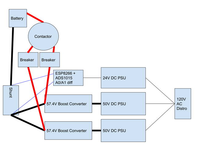

Attached is a simple diagram of my setup. Note that 24V is coming into the "control board" which houses the ESP8266 and ADS1015. There is also a 24V to 5V converter (TSR 1-2450E). I use the 3.3V pin on the ESP8266 as Vcc for the ADS1015.

A0 is on the negative side of the shunt, A1 on the positive side. Or differently said, if you look at my diagram above, A0 is connected to the PSU side and A1 is on the battery side,
Your diagram flows in the wrong direction.
Should be read from left to right, like writing.
I read that it starts with the battery, and ends at mains voltage.
Your text says otherwise, a battery charger.
The ADS1015 must have (both) it's inputs between GND and VCC,
so ESP and ADS ground must only be connected to shunt negative to ensure that.
That makes measurements single-ended, even though you are trying to use differential.
That brings resolution down, even with max PGA, to ~500 points across 50A, so a 100mA resolution.
I think you could do much better with an INA226, which is made for shunt sensing.
Leo..

Ok, so if I join the ground on the ADS/ESP to the ground of the shunt (boost converter side), then connect the other side of the shunt (battery side) to A0 of the ADS and use single-ended, it should work without damaging anything, just with less precision?
If I were to use a INA226 dev board, would I just remove the resistor on the board and use my shunt? The datasheet says it works from 0-36V, so I assume that is just the voltage sense and it would work with the voltages I have described for current sense?
Thanks for your help.
Yes. And the ADS1015 needs ±0.256V (0.512volt differential) for 12-bit resolution.
No need to remove the shunt if the INA board is close to the external shunt.
The shunts will be in parallel, and total current capability will be a fraction higher.
Slightly too low readout, but you must calibrate readout of the 50A shunt anyway.
The 36volt rating is when you use the shunt high-side (in the + line).
Then the chip can also measure voltage, and compute power.
