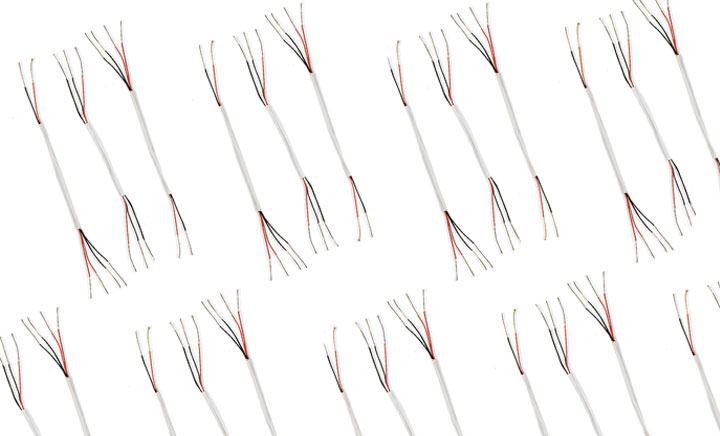

I dont know about 4 wire sensors but mine is a 3 wire one, which as you know two of the wires are just connected to one head of the PT100 resistor, I just shorted them together.
but running current through the resistor is also a great way to measure the resistance I never thought about it thanks...

Using the sensor as you do , with the connection at one end wired together means the resistance of the wiring to the sensor adds to that if the sensor creating an additional error in reading
