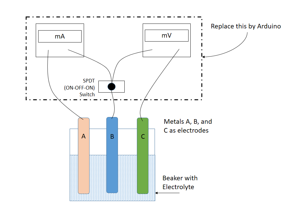

My system is nothing more than a beaker with NaCl solution, one steel rod and a graphite rod. And the voltage is to be measured between these two rods. I was considering the solution suggested by @johnerrington which was to simply toggle the connections so that the negative values become positive, but I am worried if someone could mistakenly change the connections leading to a negative voltage given to Arduino, which could damage it (?).
Also, I would be connecting another rod (another metal) in the same solution to measure the current flowing across two metals. Could I achieve this using Arduino? I will be manually disconnecting the voltage measurement connections for this using a ON-OFF-ON switch.
I have attached the schematic of what I intend to do. Right now, I'm doing this using two multimeters and the aforementioned switch.

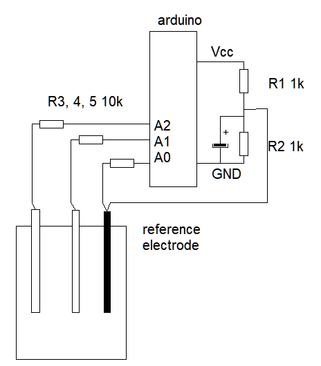

Provided the voltage is less than Vcc/2 you can use this arrangement
R1R2 provides a reference voltage of Vcc/2
All measurements are made from this level.
R3,4,5 protect the arduino inputrs.
How would you do that? To measure a current you would need a closed circuit. The voltage measurements are made on (essentially) an open circuit.

I am currently measuring the current using the multimeter. It is basically the current produced by the cell. The circuit being completed via the multimeter. Is this not possible using an Arduino?
The current is a function of the electrochemical potential and the loop resistance.
Yes you can measure the current (well, the voltage across a resistor) with an arduino, but I dont know what that would tell you.
Have you defined your objectives for this experimant?
Perhaps you should look at measuring the internal resistance of the electrochemical potential. You would need to test with a few different load resistances, and graph the results.
Bear in mind if current is flowing you will get electrolysis and the buubbles will change the effective surface area of the electrodes.
This simple circuit will protect the Arduino inputs from negative voltages and over voltages.

The current will be measured only momentarily, say for a few seconds. I'm then disconnecting this connection between the two electrodes (two dissimilar metals) using the switch and then connecting and measuring the voltage across one of these two metals and the reference electrode. As shown in the schematic previously, think of A and B to be those dissimilar metals while C is the reference electrode. The objective is to show the effect of various electrolytes and additives to these electrolytes on the current (between two metals) and the half-cell potential (between the metal and the reference).
I shall implement this for voltage measurements, thank you. Could you please tell me what software did you use to draw this circuit diagram?
To measure the current you will need a closed loop.
In which case it is the internal resistance of the cell that you need to measure. Not the "current".
You can measure Rint by taking measurements of I for two different values of Rext, then doing some algebra to eliminate Rext from the equation. Or simply by adjusting Rext until Vext = Voc (the open circuit voltage) /2
Will I be able to replicate the current value on Arduino that I see on the multimeter which is connected as per my schematic?
