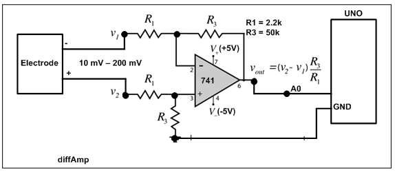

Hi all, I want to measure the potential difference that develops between electrodes (of an ion selective electrode so one of the two is exposed to a greater ion concentration that charges it on the order of tens of millivolts). I think that the electrodes could therefore be considered as a high impedence low voltage source so I seek to measure that voltage to a reasonable precision (accuracy would be good too but is less immediately important because I can simply implement an offset) and stability/noise that for starters could be the 3.3V arduino (nano ble) operating voltage divided by 10bit analog input --> ~3mV resolution. Here is an image depicting how I think the circuit might generally need to be:
The diode is meant to protect a reversed input that could damage the board. I'm not sure if I'm missing something(s) or how I should go about deciding the resistor, diode, and op (differential) amp's specifications... If someone could please with feedback and guidance toward the correct path forward, I would much appreciate that. Thanks,
edit: The voltage source and resistor in image are meant to represent how I think the electrodes behave... I don't know approximately the resistance value but think it could be high or low depending on the salinity of the aqueous solution being measured... should I perhaps be attempting to measure this value to get greatest performance? Right now I'm more focused on basically functioning than being able to function in all use-cases.

You need a professionally designed, high impedance amplifier for the electrode. The lashup shown will not work.
I recommend to use differential amplifier similar to Fig-1. If using 3.3V Arduino, then use +3.3V and -3.3V supplies for the op amp. You need to calibrate your electrodes against known 2-point which are concenration-1 and concentration-2.

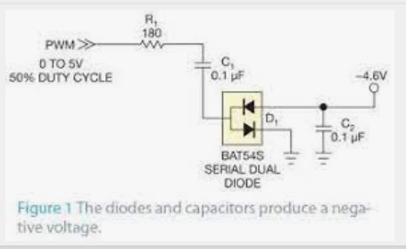

This is great if it is really so simple - thank you. If you don't mind, how might be a reasonable way to supply pin 4 with the -3.3V? A quick search is guiding me toward possibly using PWM or an external voltage source. And yes I understand and intend to do that 2-point calibration!
It is better that you use -3.3V from an external adjustable supply with GND-pin connected with Arduino. Alternatively, you can use a charge pump using PWM signal of Arduino which is complicated as you have to build the charge pump (Fig-1). Chang the duty cycle to reduce the output voltage.

You probably want to use something newer than a 741 op amp. Does it even work well with +5 and - 5V? I think the lowest I ever went was +12,-12 - that was 50 years ago, so memory is a bit hazy.
It isn't. The truly ancient 741 op amp identified in that schematic won't work well, and the amplifier input impedance of that circuit is probably far too low for your probe.
Please post a link to the product page or data sheet for the probe.
By definition and design, every op amp has an infinite (in the range of mega ohm) input resistance/impedance.
The 741 is still widely used. It works well when balanced supplies are provided for the bias points.

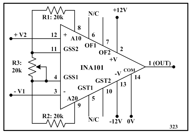

However, 741 may not work as a good instrumentation amplifier to satisfy OP's need and in that case, he may use the following expensive IA (Fig-1):
323
Figure-1:

Theoretically speaking, of course. No one would seriously recommend using a fifty year old op amp in any modern application.
It depends on application and the precision/accuracy of measurements. Average price of 741 is US$0.24 and that of I01A is US$24.00.
For this application you need a FET rail-to-rail op amp. Do you want to measure both positive and negative voltage? Or it is known one voltage is always higher than the other? What bandwidth do you need?

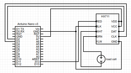

Start with something and then keep adjusting the setup for improved performance. The HX711 Module could be a good choice as it accepts very low (mV range) differential signal and then amplifies it. The interfacing with UNO is also simpler.
HX711 might be good as I recall our ex-electrical eng. describing how the load might resemble a Wheatstone bridge... In that case, could a simple starting point look like this?:
(the HX711 breakout board taken from SparkFun Load Cell Amplifier - HX711 - SEN-13879 - SparkFun Electronics)
And is CLK even necessary?
