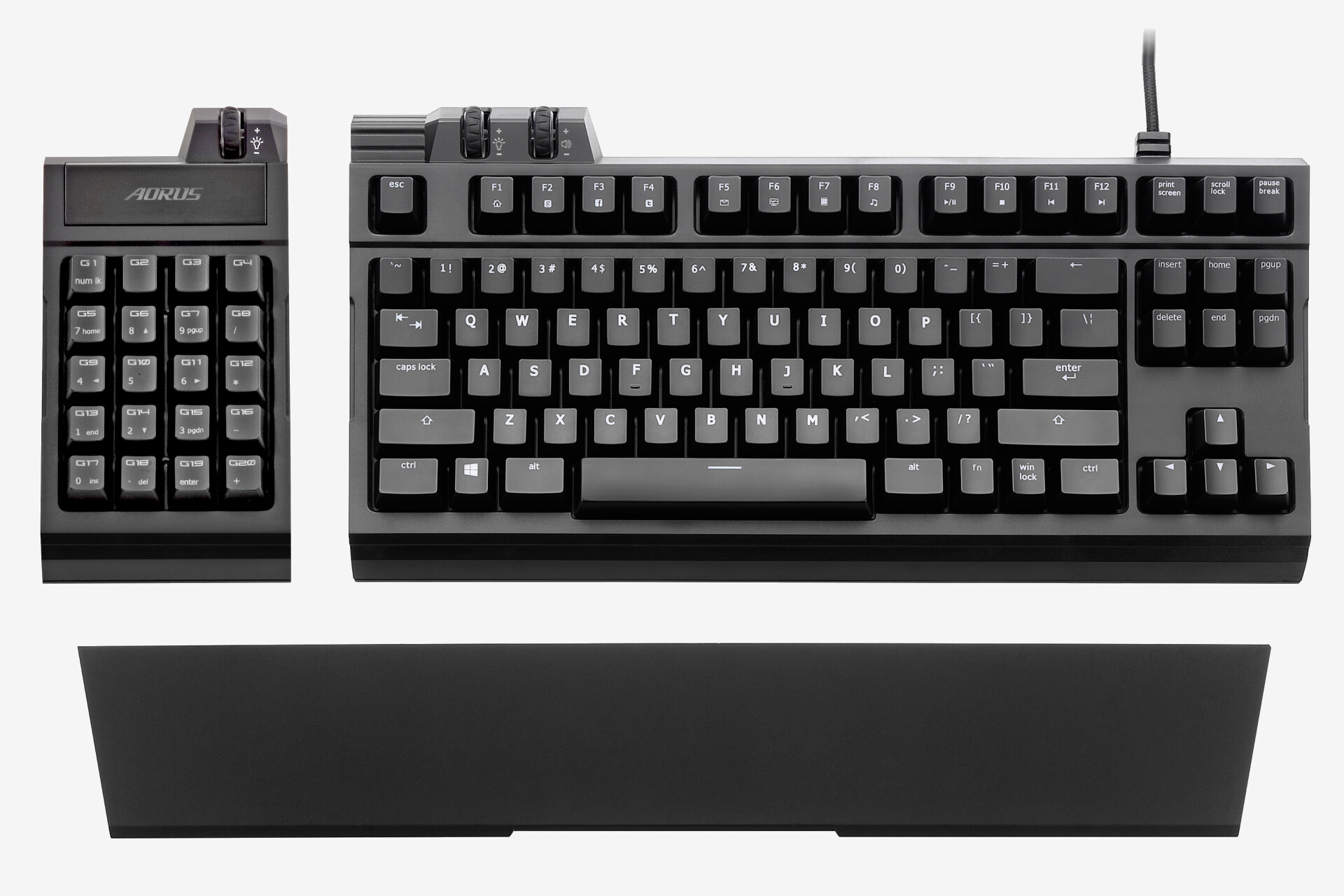

This is a quick adobe rendering of what I want to do. I'm sure the color and placement might change a little but you get the idea of what I'm trying to do.
What blows my mind is nothing like this exist. There is one project I could find where someone added a Slide Potentiometer to a keyboard but it used 2 usbs. My goal is to have 1 usb that controls both the keyboard and the Slide Potentiometer.
So my question. Is there a single Arduino product that could handle mechanical keyboard inputs and 1-2 Slide Potentiometer ?

When you look for left sided mechanical keyboards you find this.
I don't want that. I want the arrow keys on the right side and the numpad on the left. You can obtain this with a detachable numpad but most of the reviews complain the numpad keys not registering due to a poorly designed layout.
