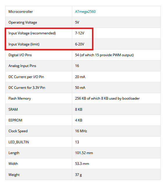

my arduino mega 2560 burn it was max 20v so i put it on 20v and it burn when i look at power supply it said 20.2v
From Arduino Mega 2560 Rev3 – 54 Digital I/O, 16 Analog Inputs, 256KB Flash — Arduino Official Store
It's never advisable to use the maximum (or minimum) ratings.

At 20V, the voltage regulator will rapidly get too hot if you are drawing a lot of current. Might be ok if you have nothing connected to the Mega, but several LEDs or other devices will be too much load at that voltage.

To provide no information about what was wired to your Arduino provides us with zero ‘handles’ to help you with. I believe you’ve provided the Arduino with a significant load which would be just fine on USB power, or with a 7-12V supply, but at 20V you’ve overheated the onboard regulator.

IF you used a regulated bench power supply, why would you select such a high value. The regulator could have burned at 18V already. NEVER go close to maximum values before that's what will happen.

20.2V is greater than 20V. 20V is listed as the absolute maximum.
And looking at a clone Mega I have here, lots of parts are only rated for 16V, not 20V.

What did you think the benefit was of running at 20VDC instead of, say, 8VDC? The board only gets 5VDC from either, with the balance being dissipated as heat in the VR.
