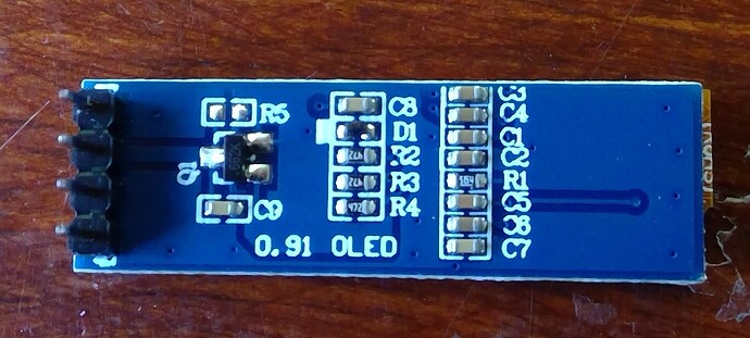

I don't see any model number, but here are pics of the one that is working.
Maybe the 128x64 I2C one is just bad.

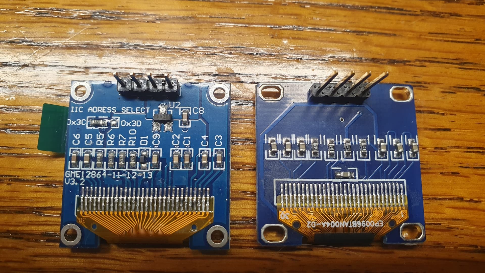

Problem solved. First 128x64 was bad. This is what happened...
  1. Bought a 128x64 I2C and it didn't work
  2. Assumed it was bad, so bought another but got an SPI by mistake. This one "didn't work" either because I was hooking it up as I2C
  3. Learned the difference between I2C and SPI after posting here and ordered a new I2C from ebay. I2C #1 was indeed bad.
  4. Hooked up new I2C and it worked perfectly. Just needed to change address to 0x3C

Note that OLED has a regulator on the back, that provides the 3.3V the OLED needs.
Some OLEDs have no regulator on the back, these are for 3.3V Arduinos.
Good one is on the left, dead one on the right. I tried both with 5v. Maybe the bad one was really a 3.3v and I just fried it?
One on the left is for 5v
One on the right is for 3.3v
