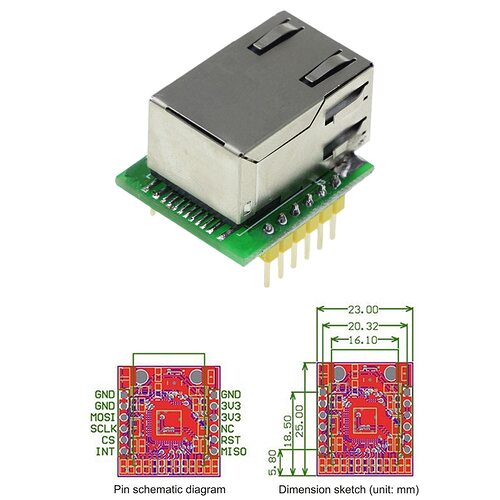

  • I wane use this network controller from AliExpress, is it a good pick?
Looks good to me. I really like the form factor of those much better than the Ethernet shields or the other style of W5x00 modules which are such a pain to mount securely.

I try to solve a problem with Ethernet modules. I have two, and hey fail on EMI from a relay. The shield doesn't. I ordered original Wiznet W550io module. I hope it will work.
I'm using one of the cheap red Chinese W5100 modules from eBay in close proximity to four 5 A Songle mechanical relays on one of the cheap Chinese modules, a 20 A mechanical relay, and a 20 A mercury displacement relay switching a 15 A load. It works fine. However, during initial testing without the relays I definitely had a lot of problems. This caused me to write my code so that the system was very resilient to temporary communication failures so that might be masking problems caused by the relays.
Are you having trouble with one of these mini W5500 modules in a DIL form factor?
I've been meaning to redo that project and use one of these W5500 modules instead of the W5100 module since the W5100 module is so annoying to mount. I've done some work with the W5500 on my workbench but not actually in a finished project yet.

W5500 lite and NIREN W5500 module. I didn't find a schema for this modules. They stop working until reset. I suspect the EMI hits them over 'ground' connection. The relay module has recommended circuit around coil. I could add a snubber circuit to AC side, but it is an ohmic load (heater), not inductive so it should not create a strong EMI.
Yes, i also did not like the shields and wire solutions that much, i wanted to be able to socket mount or even solder the module to the stepper controller board.
But on Juraj advise i think i go for the Wiznet W550io module, tho i am not that afraid of EMI as i will mount the relays about 1ft/30cm away from the board, and after reading about the problems, i will put up some shielding around the relays boards.
Juraj:
Looks a little more robust, and can still be mounted properly, so i will go for that one.

Is this the correct way of wiring the W5500?
Link to full image.
sorry I will have WIZ850io
Juraj:
The WIZ550io is basically the same, only the WIZ550io board has a PIC processor which does some config on the W5500 chip, i just wondering if the PIC chip is a plus or a minus?
And i can still change to the WIZ850io if that's the better option.
And i am just wondering if i hooked up the WIZ550io the right way?
Havor:
yes
