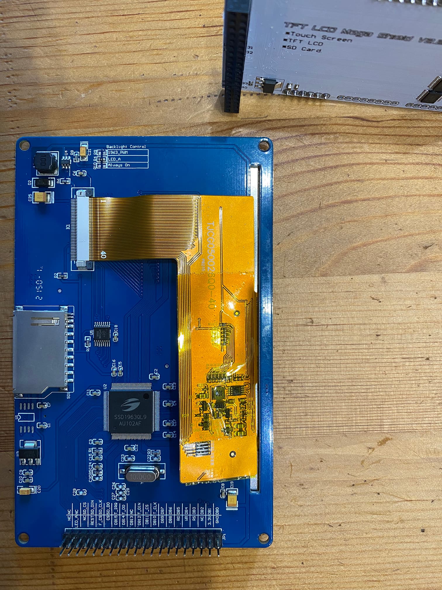

My project would be to control two DC motors with 2 rotary encoder modul following the speeds on the display, also option to choose preset engine speeds from SD card (which can be put behind the LCD).
I could program and use the shields individually, though this is new for me, so I accept any advises.

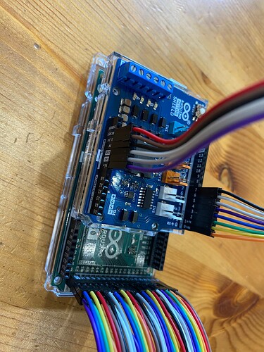

Nice pictures but they are meaningless to me. Post an annotated schematic showing how you have connected these parts together and post links to there technical information. On the schematic be sure to show all connections, power, ground, power sources and any other hardware connected.

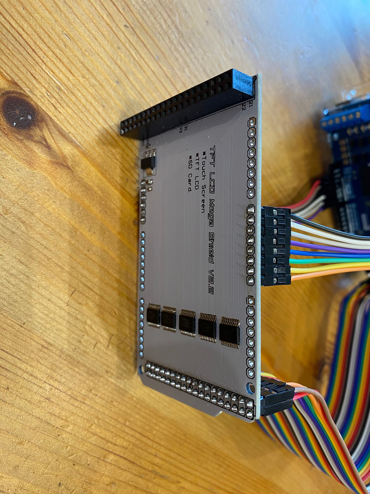

Your wiring looks very neat and that you took time to do it correctly, good job assembling it.
According to the online documentation for the motor shield, it uses D3 as a PWM signal for channel A.
Your photos appear to show D3 also going to the board that the LCD plugs in to.
If your LCD really needs D3, then that would be a problem. You should look at the LCD documentation to see if it's really used. Also check out the library for the LCD to see if it's possible to use another pin that the motor shield doesn't use. Potentially that could mean modifying the library code.

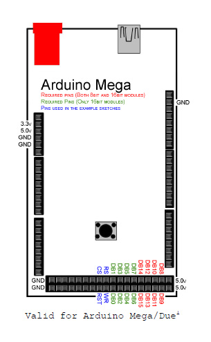

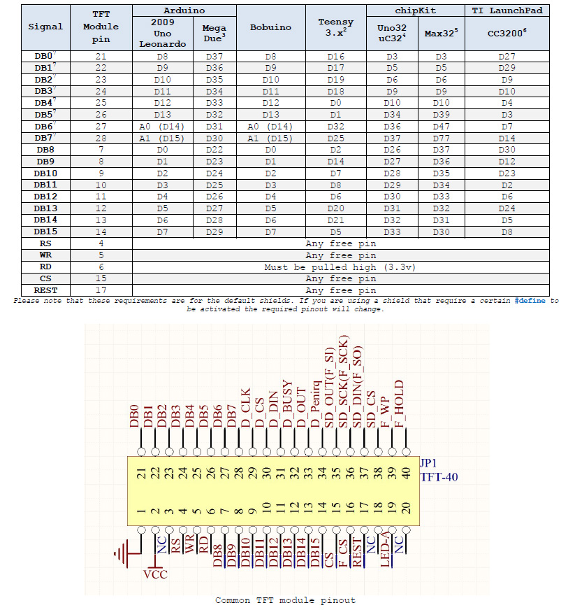

markd833 I wired the TFT shield as it was connected to Mega by itself, I didn't check yet which connections I would really need. In UTFT.h's documentations I found that the program uses these pins for 8bit LCD on Mega:
Pins: D22-D37
Any pin : RS, WR, RD (3.3V), CS, REST
However 16bit LCD uses:
Pins: D0-D7 (instead D30-37 for 8bit LCD)
I guess I can make it work like 8bit LCD, so I won't use D3 pin for LCD.
