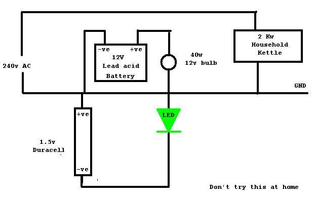

OK In your view of the world. How much current would be drawn through Ground in this simple circuit.
Okay, I'll try. I leave out the kettle, that is AC. 3.33 amps from ground through 12v 40W bulb, 0 amps through the led. An F I presume? Here is return quiz question, a typical lightening strike from cloud to ground or is it ground to cloud, which way does current flow?

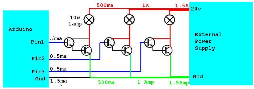

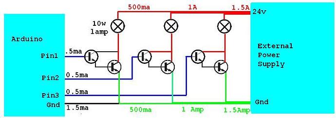

So you're using Darlington Pairs? In this case, maybe this rough sketch will be more relevant to you. It's only showing three outputs but you should get the idea. You have no worries about the power being used by your arduino. Either from the pins or the GND.
As far as I've seen you treat current as flowing from + to ground/-.
There can be discussion about flow of electrons and holes but when you calculate values, it's + to -.
