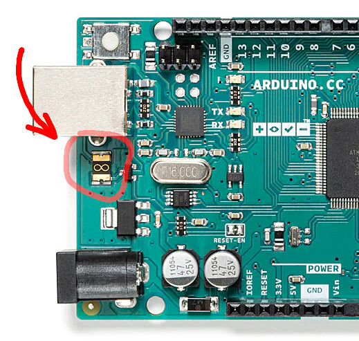

I have a Mega that started behaving strangely and causing my computer to crash when plugged in. I had a 7.3 volt power source on VIN and USB attached. I tore the setup down to the bare board and I'm getting 1 ohm of resistance from VIN to 5v. I'm pretty sure the regulator is toast but maybe I'm missing something???
Thanks for any input.

I had 7.3v on the VIN pin, and a USB cable plugged in. After I posted I tested putting 7.3v to VIN from my power source and was reading 7.3 on the 5v as well. Nothing else hooked up.

Does it have a polyfuse ?
The polyfuse triggers at 500mA.
afbeelding
Then it's for the bin.
It was acting like a short so I didn't check the fuse. I've already returned it and got an official board that's working fine.
