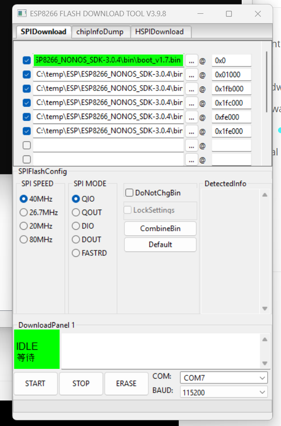

I've followed the impressive work of Juraj Andrássy and have had mild success trying to OTA with the mega that has on board ESP8266. The board connects to my wifi, I can ping it but when I try to upload using a command line (I can't seem to add the board to my IDE via wifi) I see the following message:
Connecting to board ... done
Uploading sketch ... done
Flashing sketch ... Error flashing the sketch
It seems that as soon as the bulk of the data tries to transfer via wifi the mega or the ESP resets and all hope is lost.
Am using latest ArduinoOTA, WiFiEspOTA, MegaCore ATMega2560 and I flashed the ESP to V1.7 with ESP8266_NONOS_SDK-3.0.4 using the settings below. I'm hoping someone cleverer than me might be able to help?
