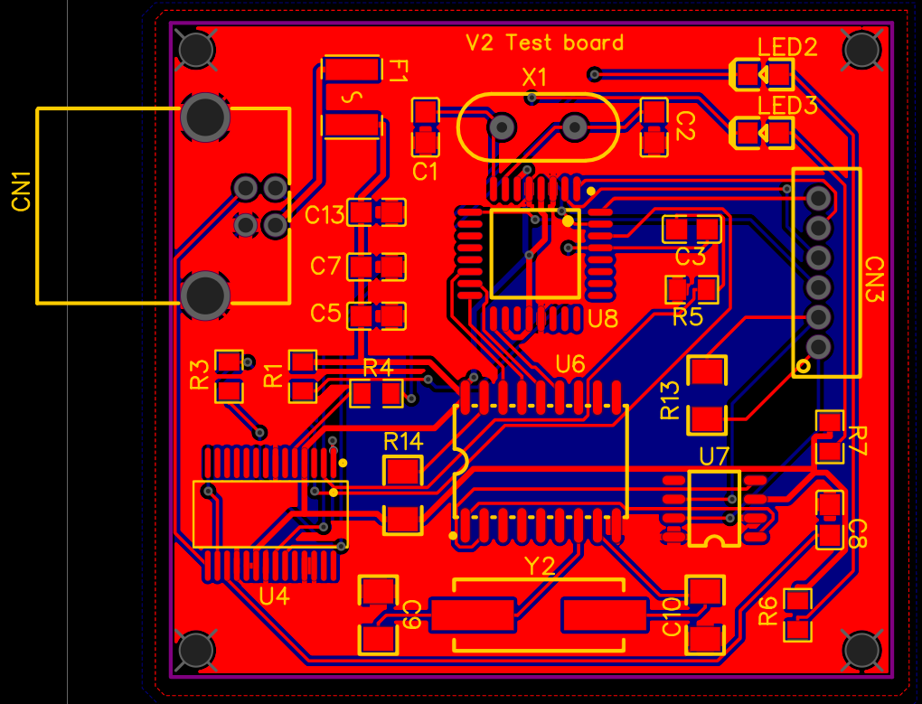

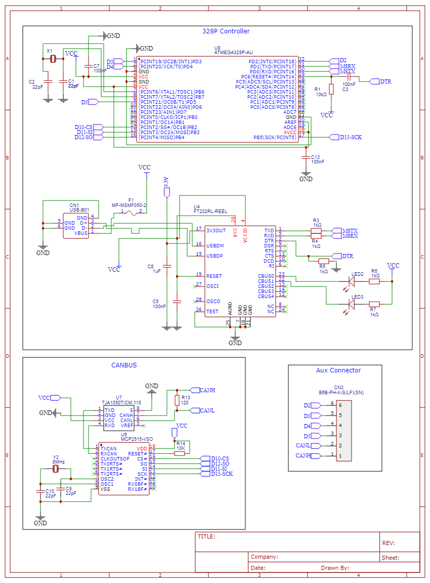

my second attempt on atmega328p-au based pcb (first one had some issues that @LarryD & @johnwasser pointed out and following their points and advice i made changes to my "v2" pcb)
** Still my PCB designing skill is below zero and im learning
This board does communicate with arduino ide and i can upload sketches, do analog/digital in/out with no issues at all so far however to get close to what my aim is in this board i added MCP2515 and TJA1050T chip so i could get CANBUS data as well.
As mentioned above atmega328 and usb comms work really well but no matter what i cannot get the canbus to work (not able to send or receive anything on canbus)
I tried @autow autowp's library as well as
@coryjfowler 's library GitHub - coryjfowler/MCP_CAN_lib: MCP_CAN Library but reached nowhere.
(using same libraries, arduino uno and a chinese made mpc2515 board i can read and send CAN data but not on my pcb)
So i thought i would post my schematic and pcb here and maybe someone can see an obvious error that i made and can help me pinpoint and fix my issue.

You don't seem to have the MCP2515 "INT" pin connected. Does the library you use need the INT signal?
My arduino uno & chinese mcp2515 board works with autowp library with no issues and INT pin is not connected
AREF and AVCC are not usually connected together as AREF cannot then be switched in software.
If changed, 100nF on AREF is needed.
A GND pour on top of PCBs is no longer recommended.
noted. will do that and remove GND pour on next pcb.
can these have effect on the mcp2515/tja1050 combination not to receive any canbus data ?

No.
Tried many libraries, tried another pcb without gnd pour but still not able to receive any CAN messages...
Can anyone help me with this ?
