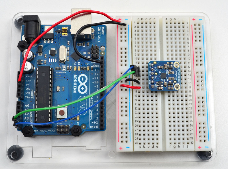

I am doing a project for my school and we are designing a metal detector. I have the Arduino Uno R3 and connected the Triple-axis Magnetometer (Compass) Board - HMC5883L in the hopes that the sensor can be used to detect metal. I have been able to get the software uploaded to the Uno but don't understand what to do with the coordinate readings I am getting.
I appreciate any guidance you can provide. I am brand new to all of this so I apologize for any redundancy, etc. My brother helped my solder the sensor to the pins which were included with the sensor.
I have attached a picture of what I have connected thus far.
Thank you in advance,
Jessica
I think you may off on a wrong track. Although iron/steel is attracted to a magnet, and can be magnetized, most ferrous materials are at best very slightly magnetic. So the magnetometer can react to the earth's magnetic field because it's everywhere present, but there's no assurance a piece of metal you're trying to detect will trigger it.
The standard metal detector generates a local electromagnetic field, which allows metal detection because it stimulates some magnetism in the target material. I'd do a little research on that.

Magnetometers are extremely sensitive to iron (ferrous) and even weakly magnetized materials.
If used as a magnetic compass, they almost always have to be recalibrated after installation, because the direction of North appears to change due to nearby ferrous objects. These are called a "hard iron" errors. A single steel screw can create havoc.
Also, magnetic fields due to electrical currents induce errors that are called "soft iron" errors.
As wikipedia claims, a magnetometer compass can easily detect automobiles several meters away, due to distortions induced in the Earth's magnetic field, so I made a gate announcer using an HMC6352 chip that tells us when someone is arriving.

Not in my experience, using the HMC6352. It reliably can sense a car passing about 2 meters away, but not much more (unless you are willing to live with false alarms). Of course, size matters.

I imagine so. The HMC6352 is an older device. To clarify, I use the device in "orientation mode" which reports the direction it is pointing, relative to the horizontal component of the Earth's magnetic field. It returns degrees in tenths, between 0 and 3599.
The noise is really the issue. The HMC6352 orientation output shows about 5 tenths standard deviation with very occasional spikes greater than 10 tenths. I set the "vehicle alarm" to 10.
In practice, a small car moving by about 2 meters away will give at least 10, but will occasionally fail to trigger the alarm and once every few days, there is a false alarm. Larger vehicles will give several degrees variation.

No chance at all of detecting "small metal objects" at 7 meters. 7 centimeters, possibly.
Metal detectors I know send a changing magnetic field out that induces a field in metal objects strong enough to interact back, all using analog circuitry in a hobby kit. The target metal didn't have to be ferrous, just have eddy currents in a changing field.
The words to look up are magnetic induction.
If you put your sensor in front of a strong magnet and wave a soda can in front of it, the sensor should pick up the field changing because of the moving metal. Gear tooth counters use that.
It will not work, see reply #8.
