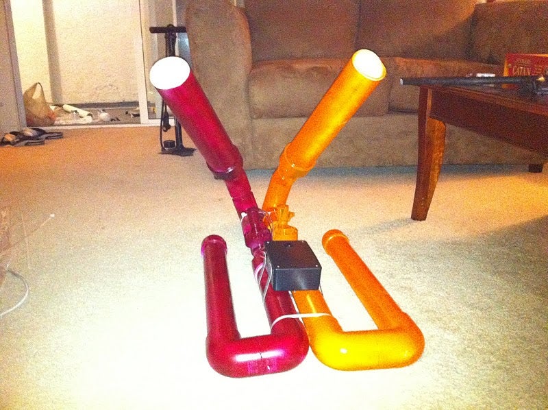

Perhaps a less messy method would be to install a compressor (hack one of the car tyre ones) and a mall pneumatic reservoir. Use the compressor to charge up the reservoir then a solenoid valve to instantaneously release the pressure. You could get some serious thrust on a projectile from this.
see the height achieved here from a small 8v compressor.
*** edit more appropriate video
Stages from start to end
  • compressor
  • check valve
  • short section of rigid tubing (make shift pressure vessel - ideally with a pressure sensor for feedback to arduino)
  • solenoid valve (your trigger)
  • short section of rigid tubing (projectile should fit within or sit around it)
Bonuses of this method being it is reusable and adjustable (just vary stored pressure)

You might use the parts from a paint ball gun for the trigger/gas release mechanism. The gas pressure might be regulated by an adjustable pressure regulator operated by a servo.
@zoomkat, just what I was thinking! You could take the paintball gun and put the CO2 tank on the end of a valve that is controlled by a servo. You would need a pressure sensor on the output side of the valve, and possibly on the input as well. The trigger could be pulled by a solenoid or servo.
