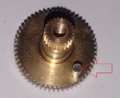

Has anyone tried adapting a 10-turn potentiometer on a 180-degree MG995 servo motor?

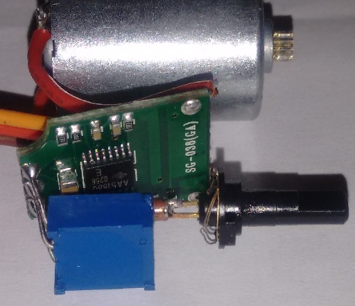

In the servo motor MG995 the control circuit has the IC AA51880, the 9926A and 4953 (double MOSFET)
The datasheet AA51880 shows that there is an internal regulator of approximately 2.45V, this voltage is applied in the potentiometer for position feedback.

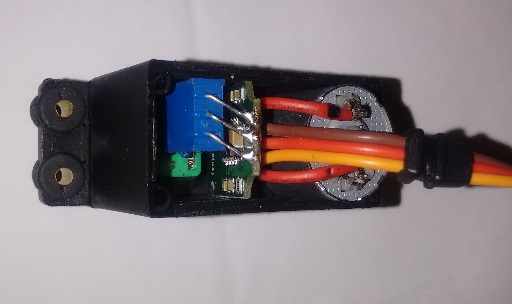

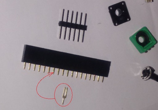

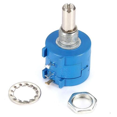

I got about 24 rotations using a 25-turn mini potentiometer (5k - 502)

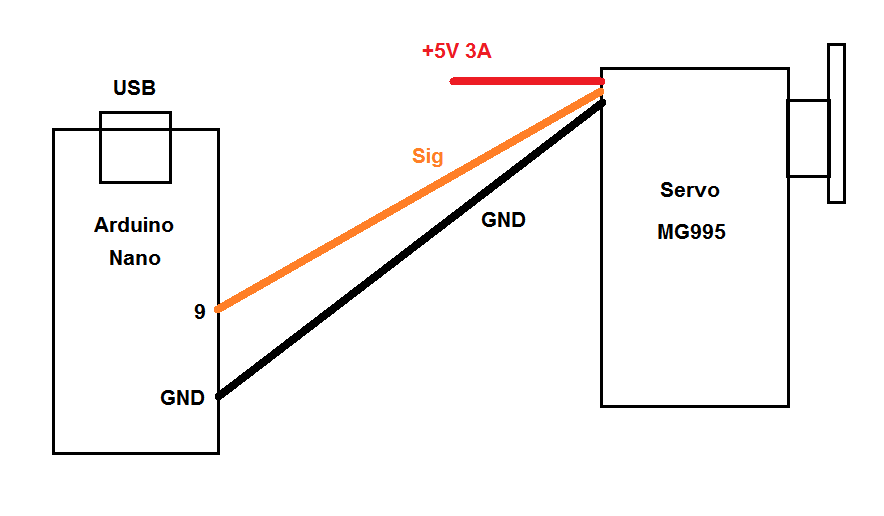

Servo motor under test:
YouTube: [Arduino] TowerPro MG995 180° - Multi turn servo (modified: 24 turns)
#include <Servo.h>
Servo myservo; // create servo object to control a servo
// twelve servo objects can be created on most boards
int cnt = 0;
myservo.attach(9); // attaches the servo on pin 9 to the servo object
pinMode(13, OUTPUT);
myservo.write(0); // tell servo to go to position '0' degree
cnt = 60; // slow blink
while (cnt--) {
Serial.println(cnt, DEC);
digitalWrite(13, !digitalRead(13));
myservo.write(180); // tell servo to go to position '180' degree
cnt = 120; // fast blink
while (cnt--) {
