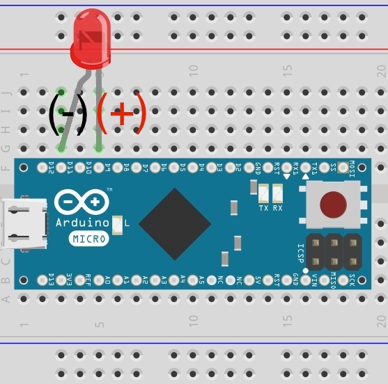

I went through and checked the pins:
Here is what I thought I was doing, two LED's in parallel as you can see in the attached diagram Two_parallel_leds
In fact what I did was two LED's in series because I did not check. The diagram shows the "What_happened"
I used a multimeter and found an "OUTPUT" pin is not "OFF" as the literature explains. When you set "OUTPUT" the pin is actually shunted to ground. On my Micro board the resistance between ground and the output pin is 25?.
Because of this my series LED's lit up with the current flowing through the "HIGH" output pin to ground. You can further test this by placing an led with positive at 9 and the negative leg in 11. When 9 goes "HIGH" the led lights up.
The only pins that are truly off are the ones that are not set as output. I don't know if this is supposed to happen or not.

What I am finding more interesting is why does the output pin go to ground?
Yes the voltage is zero, but it is a low resistance current path to ground. I have not found any voltage on any of the unused pins on the micro. Through testing I found they are not grounded either, only the ones called output are.
This inadvertent ground path was causing my error to show up. I wonder how many other errors are occurring because of this ground path? Should I be using a diode to make sure it doesn't cause a problem?

Suppose a pin is OUTPUT and LOW. That pin acts as if it is connected to GND.
Suppose a pin a OUTPUT and HIGH. That pin acts as if it is connected to 5V.
When a pin is set to OUTPUT for the first time, the default is LOW.
That's how it is and that is how it should be :stuck_out_tongue:
The Arduino would be useless if the outputs didn't do that.

You are quite right. In digital circuits, we talk about "logic zero" or "LOW" which specifically means the line in question is connected to ground. The term for "not connected" is "tri-state" or "open collector". Indeed early logic families, corresponding to NPN transistors, used logic levels of "zero" as connected to ground (by a switched on transistor) or "one" as not connected to ground given that it would usually be pulled up by a resistor to the supply voltage.
This turns out to be a very useful arrangement, and is continued with the provision in the Arduino (Atmel) chips of an internal pull-up function (if you connect a LED between ground and an input with its logic level defined as HIGH, it will glow dimly).
So the term "off", glibly - unthinkingly - written in tutorials and such, is indeed misleading.
Your initial mistake was of course, wiring two LEDs together to one resistor. You should obviously, always be providing a current-limiting resistor for each LED. :smiley: And you should not be wiring LEDs between two outputs without a current-limiting resistor anyway.
