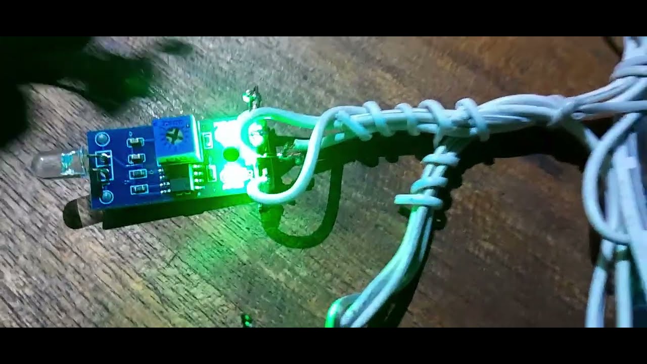

Hello, Arduino has 8 available channels for PWM so we can flash 8 different LED Setups at the same time. At this time I have external PWM module as the Arduino is still waiting parts (like LED stripe) which is best to just wrap around the Reactor (and after that aluminum and some insulation, remember to insert temperature sensor inside this setup) as the emitter /star models or overall "power LEDs" have an almost monochromatic spectrum, so they emit way too much light per area if installed about 1mm apart from the actual microalgae cells. It is better just to use warm white LEDs for overall growth and you can adjust for example the photosynthetic Pigment levels then, with adding or removing certain areas of PAR.
The O2 sensors work best with air and conuctimetry is just for example two iron Nails in the algae liquid: but with the CO2 you should ask yourself, why you use that in comparison with pH as its yes related but actually the pH is not good scale in adjusting C2 as its 1) logarithmic scale (the need for CO2 in photosynthesis in the Automation Logic isn't logarithmic) 2) pH measures the hydrogen actually so in the bigger picture, there isn't any reason to add these kind of Logic into Automation in first place, as they will mess up the rest at some point.
We have on next parts package some CO2 sensor, couple different light sensors so will update them here too. Here is one sample code, we made more now to the Arduino with my friend Nova (Chat-GPT:)

Some sensors I received and tested, sorry its still in finnish
