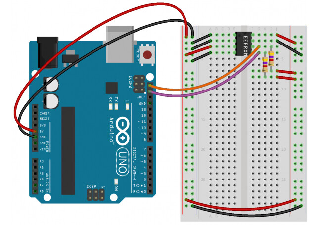

I am using the following hookup guide except with all address lines tied to GND and I am using a Mega rather than an Uno.
This is the result from the IC2 scanner sketch:
Scanning...
I2C device found at address 0x50  !
done

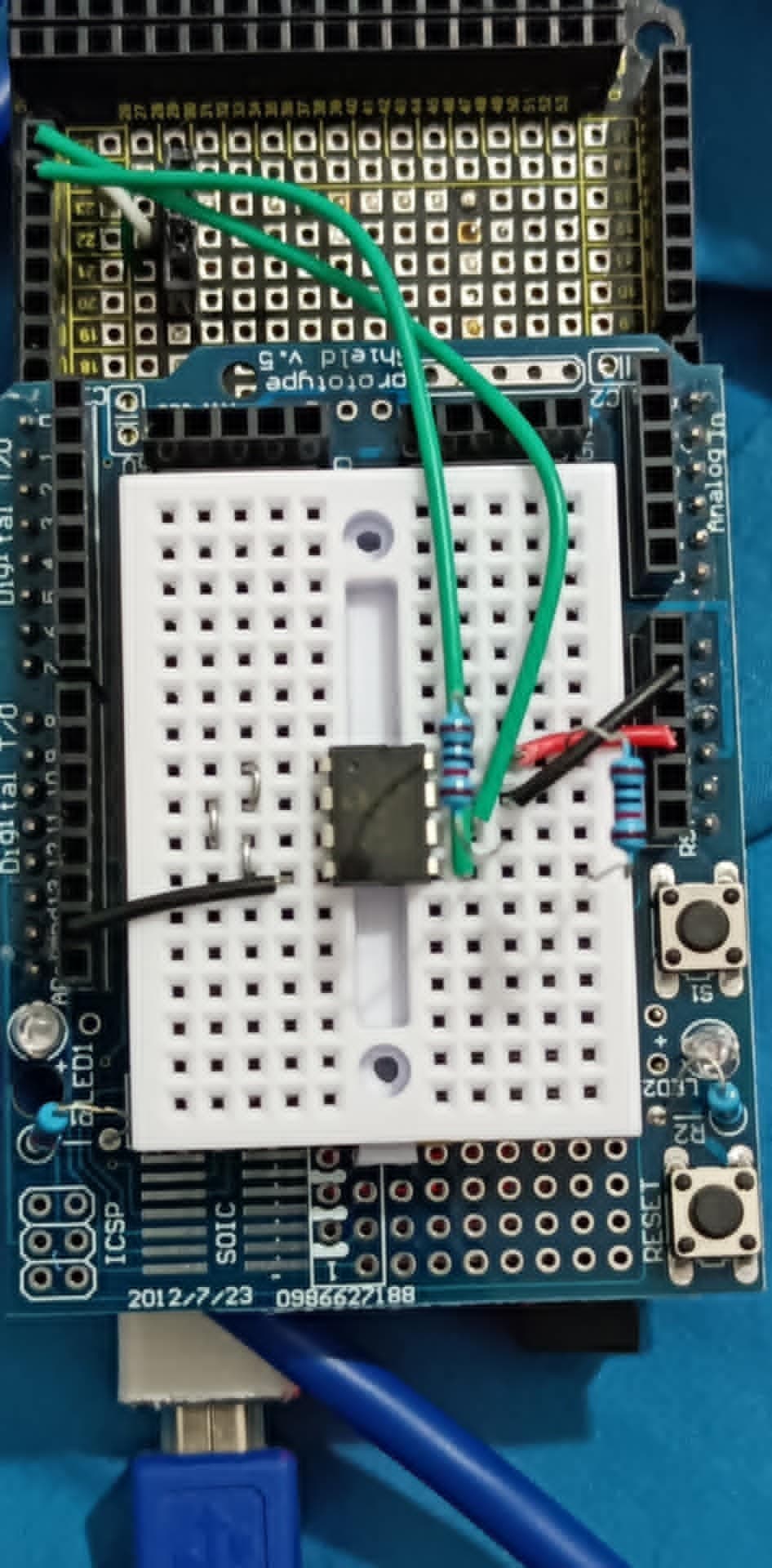

This is my actual setup...
I have tried with and without the pull up resistor on the CLK pin.
Either there is a bug in the wire library or else Jaycar has a bunch if fake or faulty chips.
I can't see anything I have done wrong with the wiring.

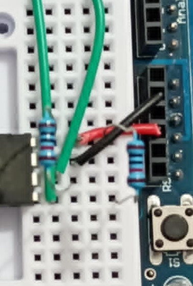

What value are those pull-up resistors? They don't look like 4.7K.
I would place no money on there being a bug in the wire library. At this time it's like cleaning you've found a compiler probelm like "is the if statement broken ATM?".
a7
.1µF decoupling cap not seen across Vcc-GND.  Don't know it's mandatory for this chip but it's standard for other digital chips.  What could it hurt to try one?

The library appears to be fine. The sketch appears to be fine.
I'd be looking at wiring problems or incorrect pullups. And only if those check out would I consider a bad EEPROM.
Look like 10K 1% Brown, Black, Black, Brown, Black
How many boards do you stacked on top of the Mega?
Is WP actually grounded?
I don't think there is a black tolerance band. And I think your reading would be 100 * 10¹ = 1K?
It's hard to get the colours correct against those blue backgrounds. But I think I see brown, black, black, red, brown, which would be 100 * 10² = 10K 1%.
But which of the 2 brown bands is the tolerance?
Read in the opposite direction, it could be 120 * 10¹ = 1.2K
Hi, @van_der_decken
Do you have a DMM? (Digital MultiMeter).
If it was a 6 band the black would be a temp co-eff.
Yes it could be a 1K, in this case I'd measure it.
1K2 is also a possibility, the band spacing is not exactly good.
I guess both values would work...
What happened to the old days when we had a golden band? Never any reason to doubt in which direction to read the bands...
We've lost it, my precious...

With a 4th black band, isn't that 120 ohms? A black multiplier is 10^0, not 10^1.
Ha! You got revenge for @TomGeorge :wink: You are of course quite correct.
I imagine we all think they're likely 10K, but a quick check with a meter would confirm or refute it. Mind you, the OP has been battling with their Mega and EEPROM problem for a month and a half now, so I'm not hopeful for any quick resolution.
