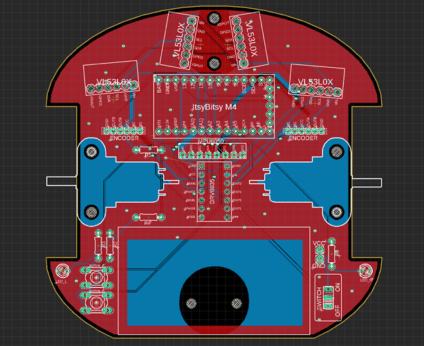

Just added some pull up sensors but it's still detecting no I2C Devices... Also, I checked and both the SDA and SCL lines give 2V, shouldn't this be 3.3V? The power supply of the sensor is steady 3.3V.
cornedej2001:
Are you using an oscilloscope or a multimeter?
PaulRB:
I'm using a multimeter.
I really don't understand what's going wrong...
Right now I've added some Pullups of both 3.9k. And wonderfully it's now detecting the I2C device!
Scanning...
I2C device found at address 0x68  !
done

However, I immediately came stuck at the next problem. Which is that I keep getting the same values (though they are different from the -1 values I had at first...). So it seems to be that there is still a flaw somewhere. These are the values I get right now when trying to use the MPU6050:

Could it be because the pull up resistors are 3.9K and not 3.3K?
This is an image of my current setup.
With the I2C Scanner it does detect the sensor, but somehow I keep getting the same values (see post above).
I hope someone can help me telling what could be wrong?

Multimeter can only read the average voltage, so for a data line, its just reading the average of all the 0s & 1s, so all a multimeter can tell you is that there is some data being sent, but it can't measure the peak voltage, which probably is 3.3V. A 'scope would let you see all the data and let you measure the peak voltage. But 'scopes are expensive bits of kit, at least for anything decent quality.
I will dig out my mpu6050 and hook it up to my Nano-Arm to try your sketch. Might not be until the weekend.
I would appreciate it very much if you would to that for me! In a meantime I will still go testing some other setups and maybe some other codes, see if I can get it to work. If so, I will let it known in this forum.
I'm curious wether you can get it to work with my sketch :slight_smile: I will hear from you.
Ok, no problem.
Can you please stop using Quote when you reply. Use Reply instead. Only use quote when you want to refer to short parts of a previous reply, delete the rest. Using Quote just makes the thread twice as long to scroll though and does not add any value.
Short side note: solderless breadboards are very tricky. ANY connection may become loose and it may take a lot of time to find where is the problem. Any small movement of any wire may break connection of the wire or another wire in the same row! Used breadboards are worse ofc. Mixing pins of different width make it worse. They are good for prototyping and testing (and you will learn to debug bad connections quickly) but for "final robot" you NEED soldered connections (or some other reliable connection). At least for critical parts.

Here's what I get with your sketch on my Nano-ARM:

And do these values match with the movements you make? I guess mine is just broken then...
Yes, they seem to. At the start, the circuit was stationary. Then I picked it up, tilted it around and shook it, then put it down again, and you can kind-of see that happening in the output.
Yes, my next guess is that your sensor is faulty. Fortunately those mpu6050 sensors are not expensive.
Thank you very much for testing it! Right now I've ordered a new MPU6050 in the hope that the next one will work.

I've finished all the testing and designed a PCB board for the micromouse! I hope everything is okay, because PCB designing was totally new for me. But I think I did a pretty good job :slight_smile:
Looks good. Is there a second pcb raised above this one? That would make accessing the ItsyBitsy's USB socket difficult.
