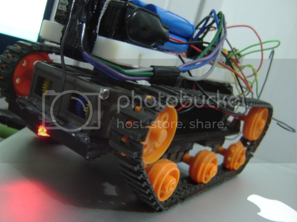

Well here is my version of the arduino rover... which actually uses an iDuino, a Tamiya tracked vehicle kit (modded), a SRF-02 ultrasonic range finder, and some crappy code!
Here I will post some pics and videos, I won't post the code unless anyone is interested... its quite embarassing. :wink:
If you don't wish to view the progress pics and vids, here is the video at the end, of the latest version, doin its thing: - YouTube

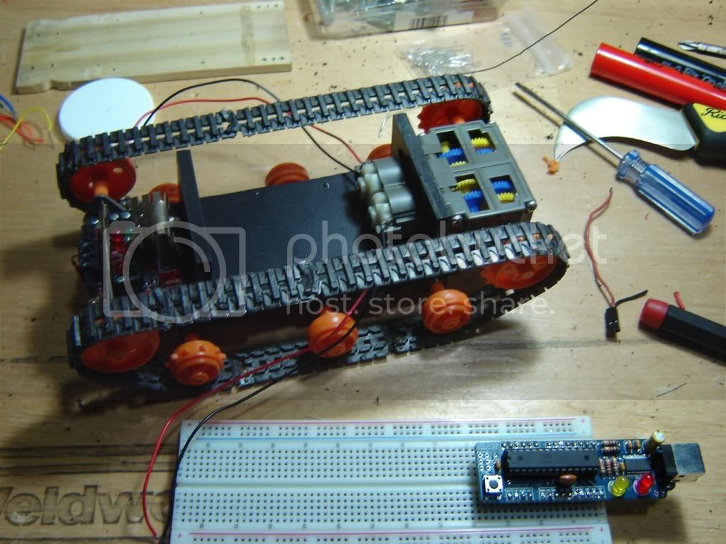

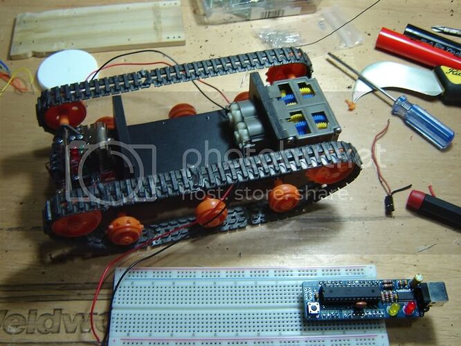

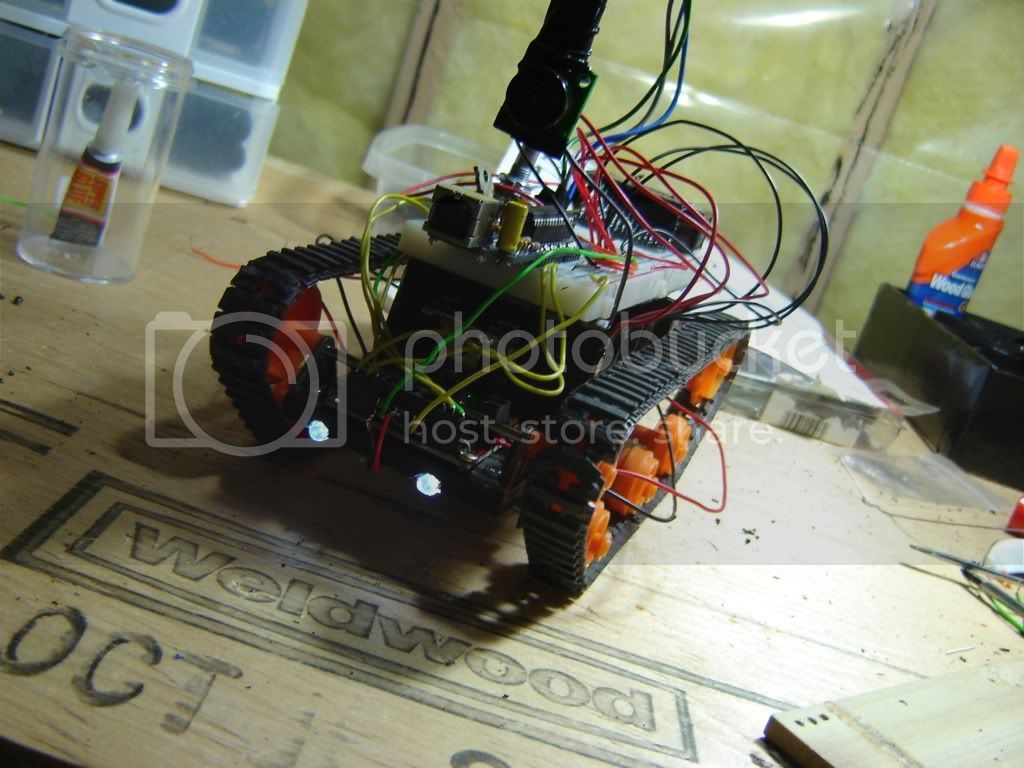

This pic was taken after I took the Tamiya tracked vehicle base out of the box and assembled it, haha look at it, what a POS! Only has one motor, so forward and backward... ordered a dual motor L/R independent gearbox, but it will be a while before I get that.

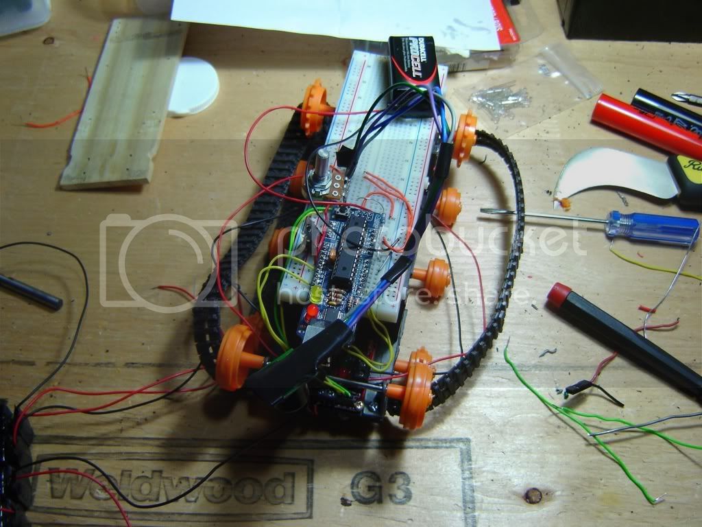

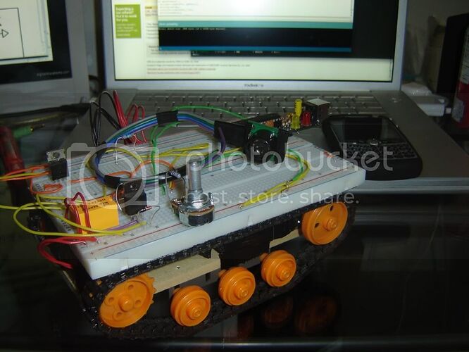

I put two breadboards together for lots of room, originally I planned on using the transistor + DPDT relay for motor direction and speed... that would have been pretty big if I ever set it up for the two motors.
Here is a video from that point of progress...

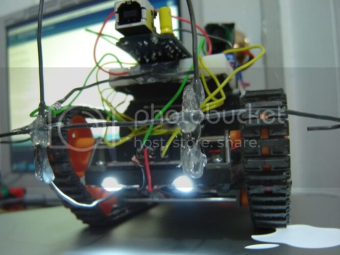

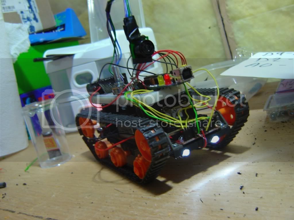

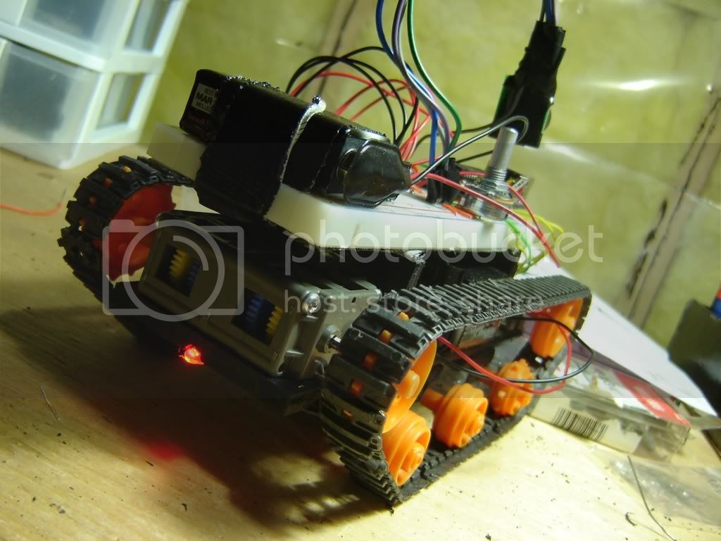

And heres a couple pictures after I mounted that stuff on the vehicle chassis, you can see the SRF-02 ultrasonic range finder laying on top in the first pic:

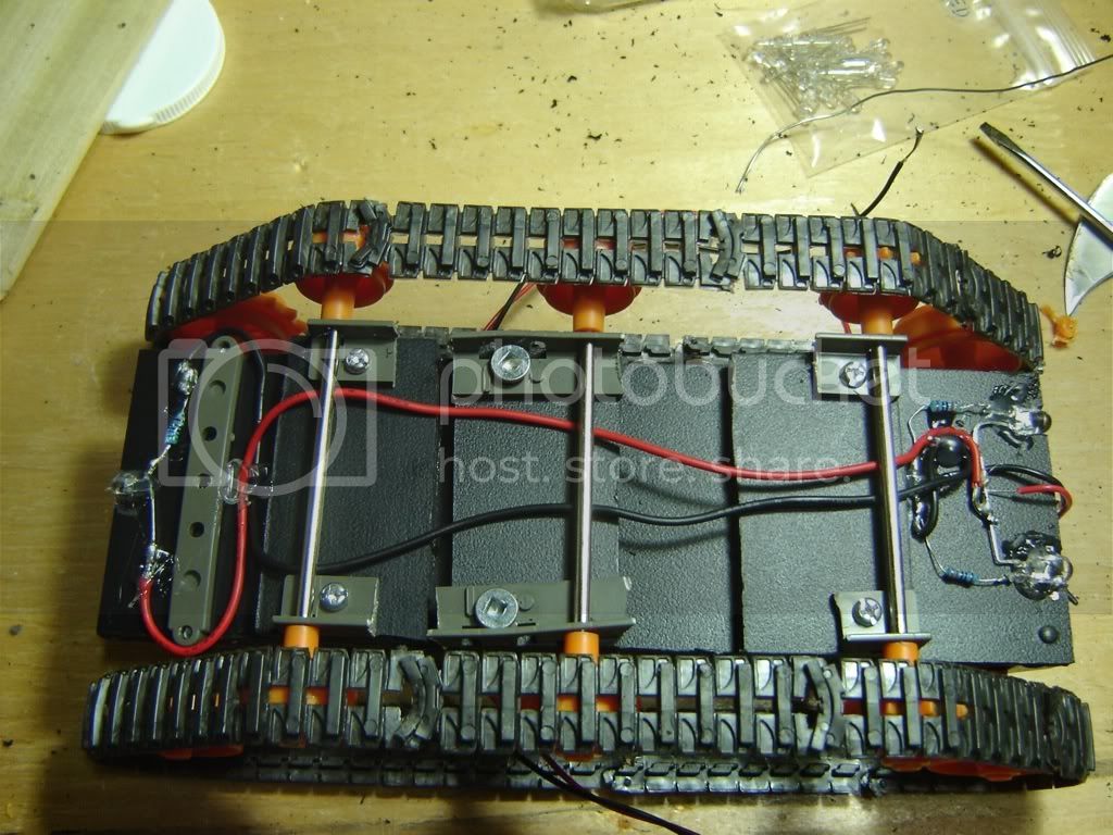

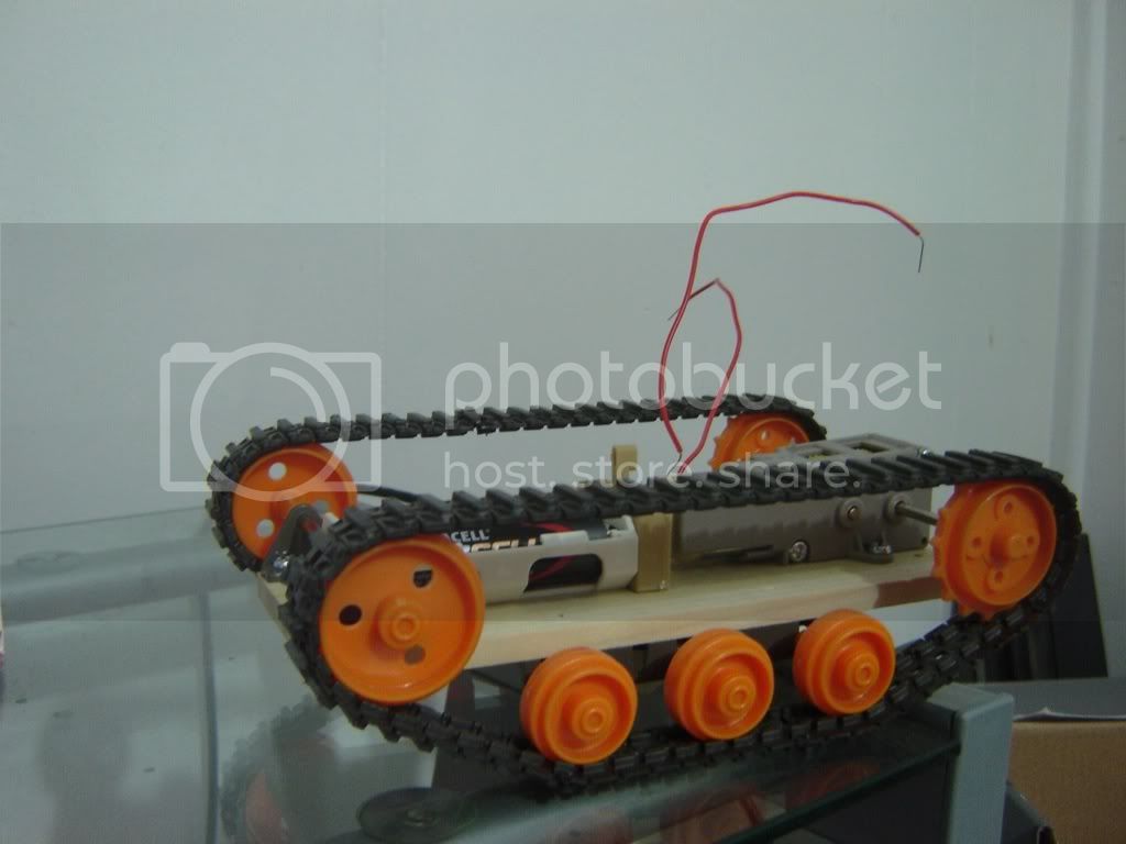

I did get the dual motor L/R independent gearbox installed in that chassis, and heres a video of that,
- YouTube - Ignore the music, youtube did something strange to the sound of that one, and it was all really distorted, so I randomly picked a song on the Youtube AudioSwap page... ugh... You will also notice a red square PCB on the back now, instead of the yellow DPDT relay, I decided to go with a L298 motor driver package instead because it was easy and readily available in 'kit form'.

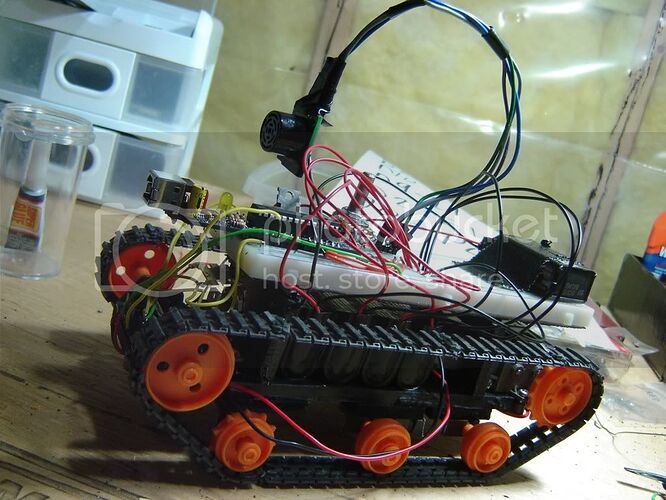

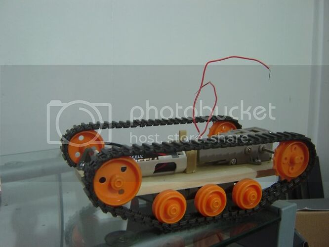

Anyway I started having trouble with the tracks coming off on carpet when it was turning, and the chassis was limited by the fact that it was a simple piece of wood :smiley:

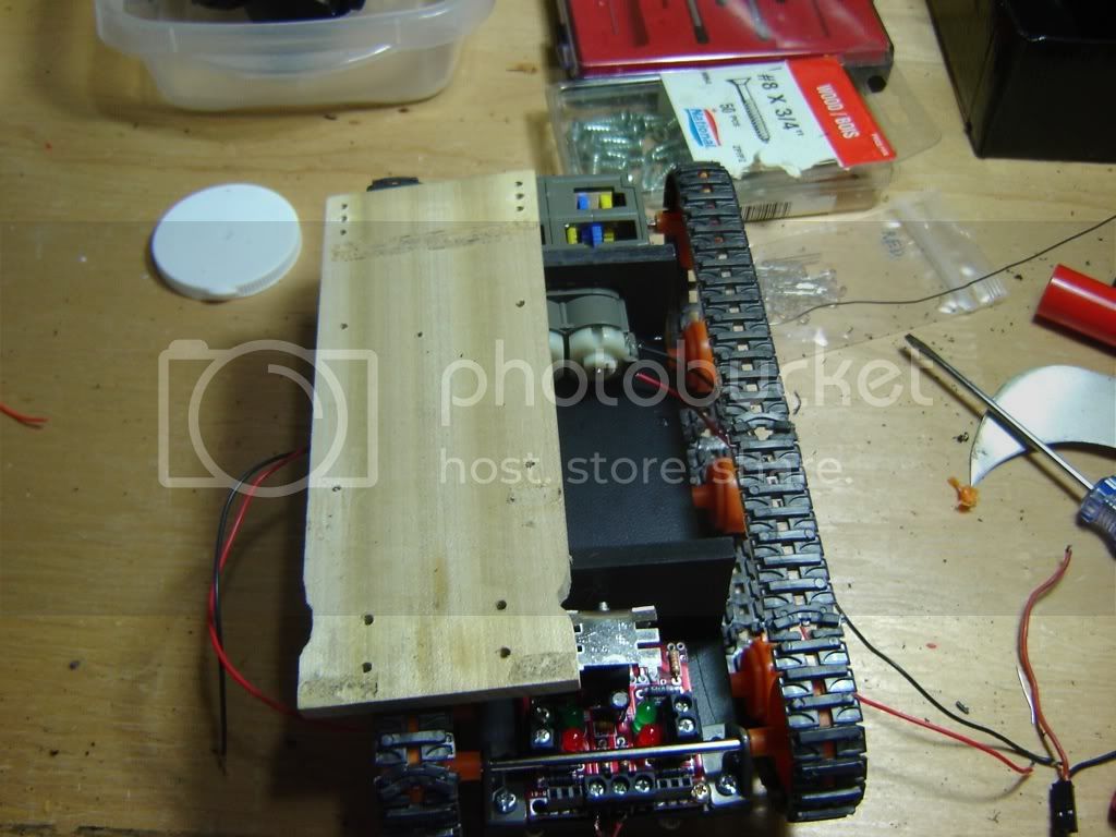

So I set to work rebuilding it from scratch, using some lightweight material I found at work, cant figure out if its closer to wood or plastic... but it works!
Heres the old chassis sitting on top of the new...

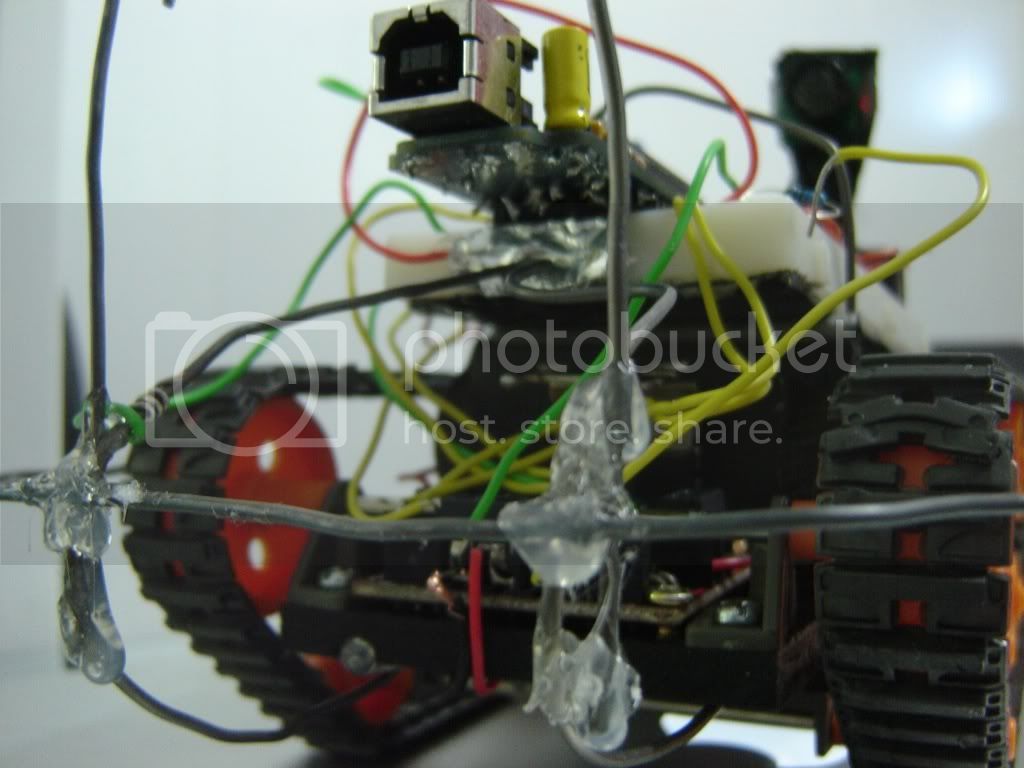

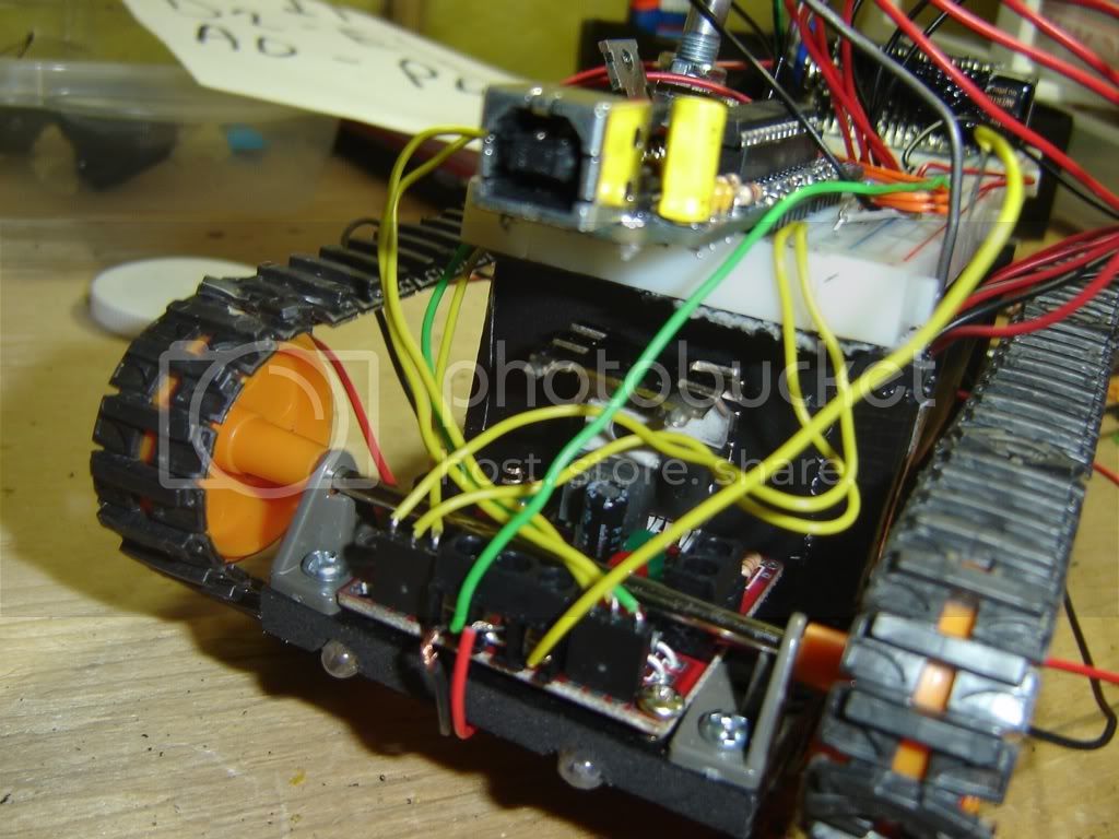

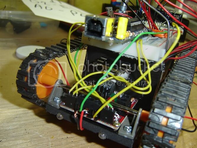

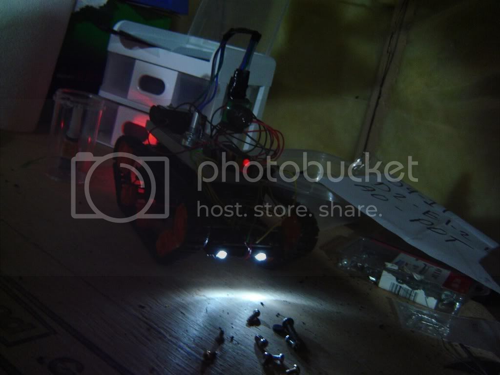

Okay, I don't like how I have the sensor mounted, and I have this problem where the ultrasonic sensor won't quite pick up objects at certain angles, and it will run into the wall and flip itself over. So I devised a way around this, by creating a terribly ugly bumper on the front, hot glued together, which when pressed on turns a pin HIGH, the vehicle then backs away and scans for a new path.
Heres some pics after that was added...
And finally, a video of the rover in its current state... don't mind the mess, im renovating that kitchen!
Future? Well, I plan on mounting some more range finders on it, possibly on a servo that can swivel the sensors around, or maybe even pan AND tilt... not sure. The whole reason it has the stupid bumper guard on it in the first place is because the ultrasonic range finder is stationary, and at angles it does not pick objects up properly... more sensors are definitely needed before I can remove the bumper guard switch....

You see that black thing on the back, on the end of the spring whip? That is an ultrasonic sensor with an I2C interface, it just isn't the exact same one that you have linked. If you take a look at some of the code I have posted, you will see right away that I do use this sensor for object detection. Also as mentioned in my post above, I will be adding an infrared rangefinder on a servo at the front of the vehicle. So I will be utilizing both types of sensor at the same time.
The tactile sensors on the front are there because the ultrasonic sensor is highly sensitive to angles, so until I have the IR range finder swiveling to 'look around', the tactile sensors are the best way to avoid burning a motor or my motor driver out if something does get past the ultrasonic and it gets stuck up against something.

Bit of an update... I got my xBee transceivers and I have tested them in a different project, working great. I am going to start implementing the wireless serial first between the computer and the rover, and later build a second arduino device to be the controller, with the LCD screen and all that on it. Bummer though my I2C-It IR rangefinder from solarbotics/hvwtech seems to be faulty, so I have to send that back and for now im stuck with the ultrasonic by itself.
Today though I am working on the ability to give 360 degrees of sensor readings, and also provide some useful tilt and auto levelling for the sensor platform. You see, every time the rover is going down a ramp or hits a little bump it sees the ground as an object to avoid. I have to work on the code a little bit, maybe even rewrite some major parts to avoid such heavy use of delay(). Then the auto levelling will work faster, right now its still very slow to react and it still gets bunk readings from the ground sometimes.
Here is a video of the auto levelling. - YouTube
I am working on the 360 degree view now also, however the sensor platform has to flip over so its upside down, which results in it pointing the other way, so one idea I had is if I could create 2 arrays with 360 values in each, in the x array I would have the pan value and the y array the tilt value for that corresponding 'degree'. That way I could just specify I want N degree and it would take care of where the tilt and pan have to be for that degree... not sure how well that would work or not but im going to find out :slight_smile:
Thanks for looking.
Okay here we go, got the 360 degree sensor platform operational, sounds like an unhealthy bubblejet printer :stuck_out_tongue:
I did it preset steps of 10 because I couldnt think of any other way, the arrays would have been enormous to do all 360 steps...
int panDegree[34] = {87,77,65,54,47,40,33,24,19,10,163,151,140,127,115,104,92,82,72,62,52,41,30,20,160,155,150,145,137,130,123,115,106,97};
int tiltDegree[34] = {19,19,19,19,19,19,19,19,19,19,172,172,172,172,172,172,172,172,172,172,172,172,172,172,19,19,19,19,19,19,19,19,19};
that is what allows it to flip over and (attempt, poorly) to keep going where it left off.
To me there is no clear way to do that stuff with math... if someone out there has any ideas on calculating angles id love to hear them... but I think I am just going to have to steer clear of complex math formulas for now lol. I am a mathematics failure. >:(
