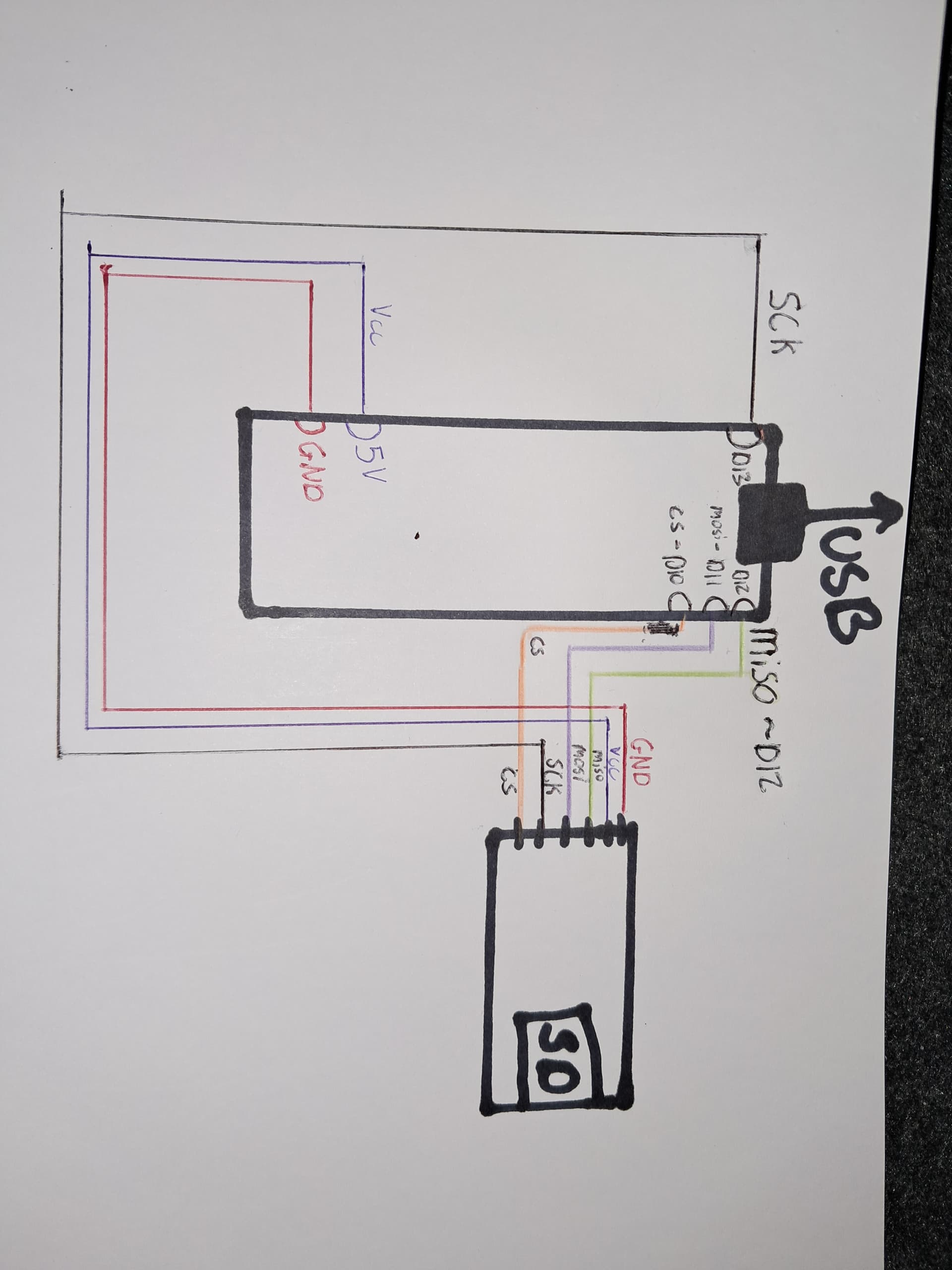

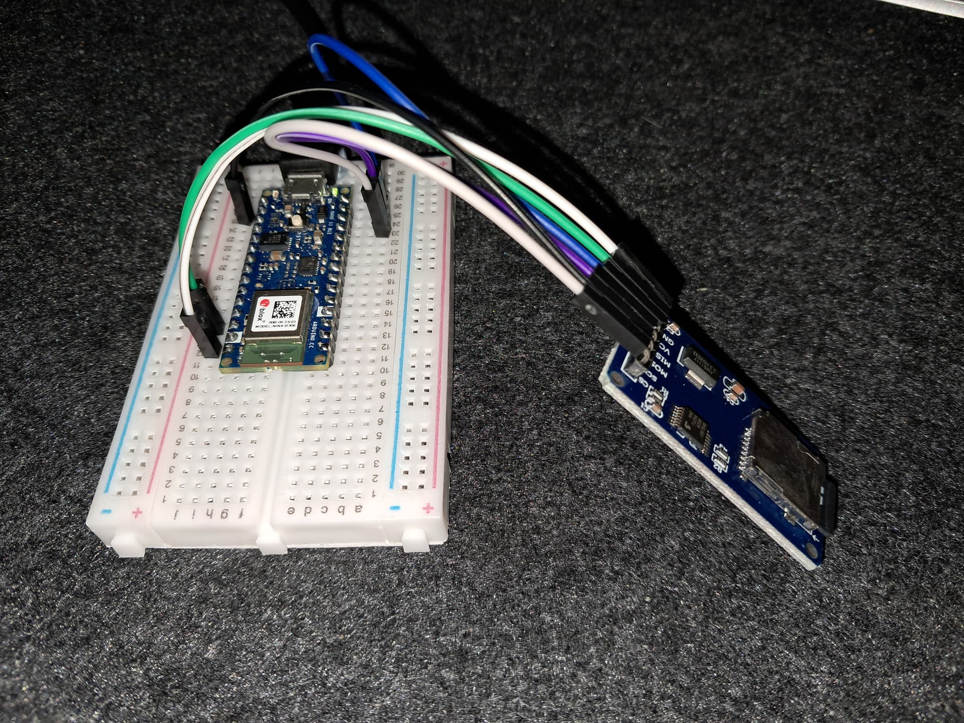

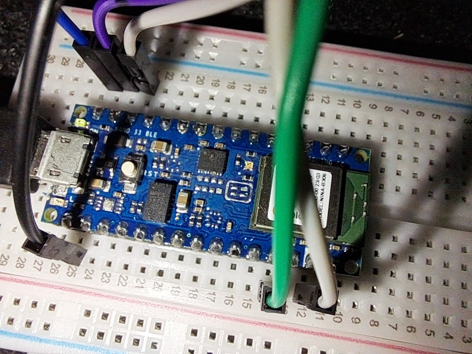

Please draw a labelled schematic, take a picture and post. Also post ALL code in code tags using ^^^^^^
What voltage does the SD card module run at ?
It is impossible to see from your pictures which is one reason for asking you to post a schematic. A 'photo of a hand drawn circuit is good enough
Here's the code and schemeatic:

You are creating a rod for your own back using a breakout designed for interfacing to a 5V board with a 3.3V board.
With a 3.3V board all you want is something that breaks out the signals w/o all the level shifting stuff. Something like:
Thing is, I've seen arduino nano used with my sd card module and it works fine, are you sure the level shifting is the problem?
Never mind then. Please disregard everything I said.
I think his point is that you need the level shifters for it to work with a regular Nano, because it's a 5V processor, but you don't need level shifting to work with a 3.3V processor.
However, I think it should still work so long as you power the SD module with 5V, and that 5V supply can provide enough current. You will be translating 3.3V to 3.3V, but it should still work.

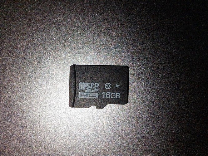

Do this specific card and this specific module work with a regular Nano? Is the card 32GB or less? Is there a CardInfo example specifically for the 33BLE?
This is the card, I'm pretty sure the code works for all nano's but I'll have to do more research.
That card should work fine.
But you can't just say "all Nanos". The original Nano used the Atmega328P microcontroller, but the 33BLE uses something completely different. It's a Nano only because the Arduino guys made a bad naming decision. I don't know if the original CardInfo works with the 33BLE. Maybe someone else can say if that's the case.
