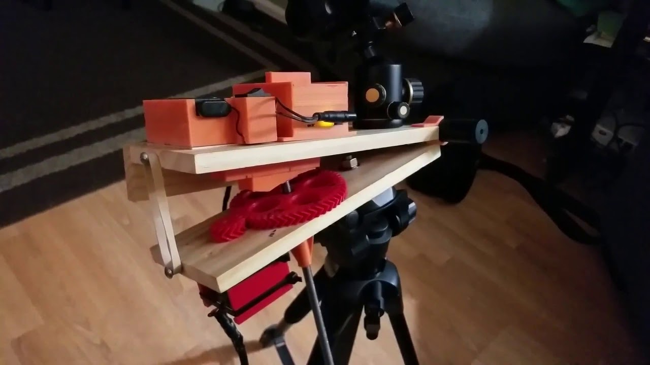

I am somewhat new to Arduino coding, and was wondering if someone could help me out with some microstepping.
I currently have a Nema 17, stats below, paired up with a A4988 stepper motor driver connected to a Arduino Leonardo.
My project I created is a barn door mount for star tracking. Basically, I just run this to track stars at Earth's rotation speed to get steady pictures while stargazing.
I created the mount and had some success with it, but am having issues with the motor hesitating and I believe it has to do with my programming, set up and coding seen below.

So a couple things....One, what can I do to stop this from hesitating? Two, how do I microstep the motor to make it turn more smoothly or am I already microstepping and don't know it? I am not grasping the basic concept of microstepping even after reading the tutorials from here, so hoping someone could lend me a hand. You can see a video of the mount running below. Thanks!

Okay, so the need for microstepping is to limit the vibration on the device, since the device needs to be a steady as possible for the camera to take steady 10 minute + exposures to prevent stars from getting elongated as the earth moves. With the motor at full step, the jerkiness between each cog for each step causes the camera to jerk a bit, causing stars to not be perfect circles.
So I figured that in full steps, the stepper motor would need to move 295 steps in order to move the bigger gear 203 degrees every minute. The timing seems to be spot on from tests I have done, but I needed the motor to run more smoothly. I will be honest, not even sure if the coding I supplied was the most efficient or even done 100% correctly, but in my eyes, it worked and all is good.
So now with the info you guys supplied, I have tried this with 1/2 step, simply multiplying the stepper.step 295 by 2, and it seems to be running at the speed I want.

As for this device, the way it works is that the stepper motor has a small gear attached, which is connected to a big gear, which the big gear turns around a bolt that make it rise over time. The rise is what matches the speed of earth's rotation, lifting the camera in the same direction as the star movements to match. You can see this in action in the video linked below.
