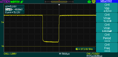

Well, I don't know if that was better ...
Here is a single bit, using 330 ohms in the circuit above:

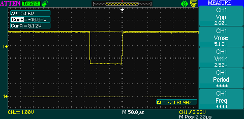

And how it was before, with 1.8K:
It seems to me that the 1.8K gives a better looking bit.
(Cursor B was about a pixel out - it was supposed to be on 0V).
Now the other factors come into play. The MMA does not specify an optoisolator but its CTR (current transfer ratio) can be important. Your TLP521-1 has (in its least expensive rating) a 50% CTR. You may need to find one with a higher CTR. For example, an Avago 4N35-000E has a 100% CTR and will probably do much better.
You can test this theory by (temporarily) lowering the 220ohm resistor on the input side (could be dangerous if what's driving it can't handle the current), or driving the input side yourself with a controlled voltage source to see at what input current level the output starts looking nice again.

Just so I understand this, are you saying that with the 330 ohm resistor, the fact that the bit only goes "halfway down" is because the optcoupler is only driving it 50%?
And therefore, if connecting up a different MIDI device which puts out less current, it might not even go that far, and thus I would not get 0 bits when I expect them?
Correct. Either that or the device driving the input side of the optoisolator cannot supply enough current to sustain ~8mA of current through the LED.
