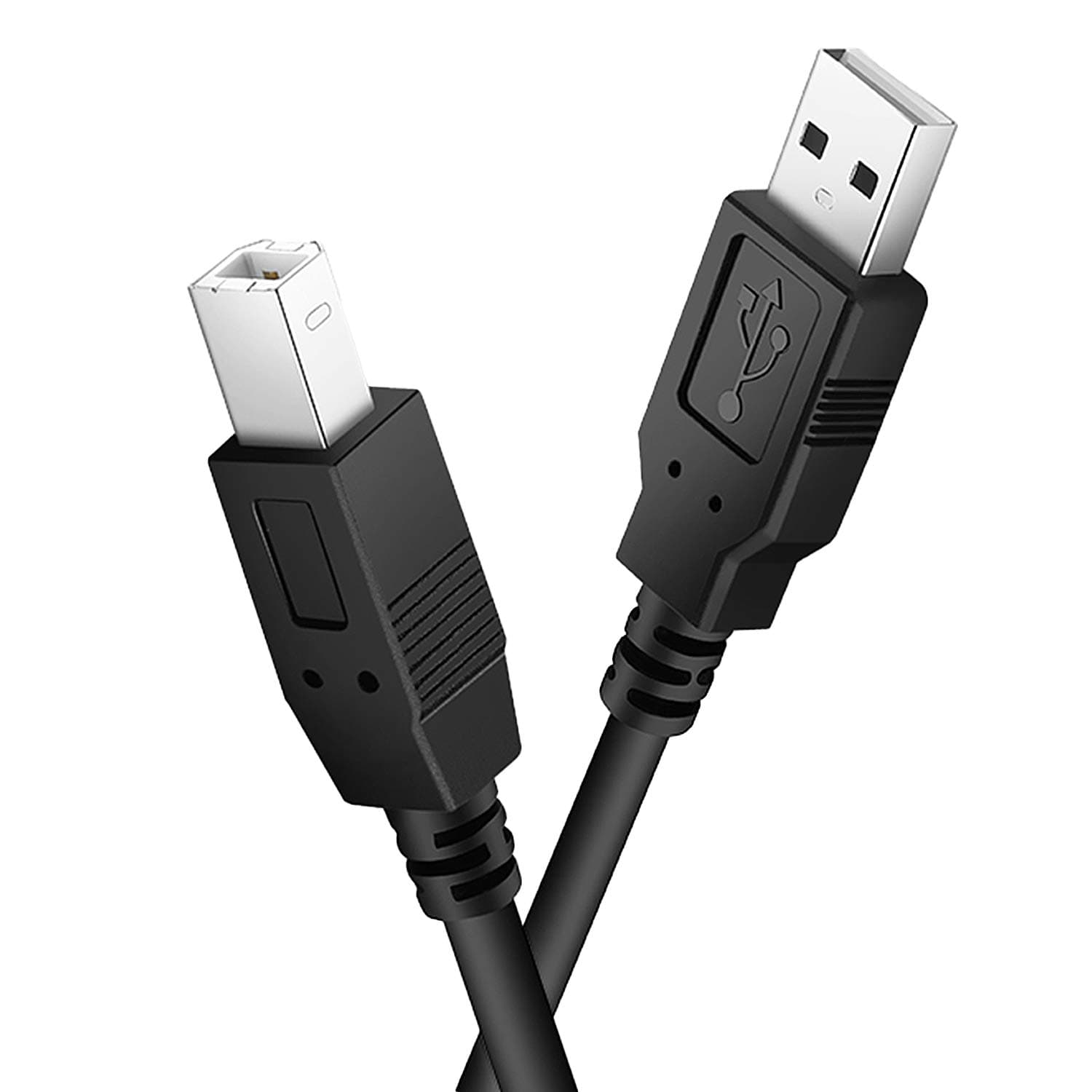

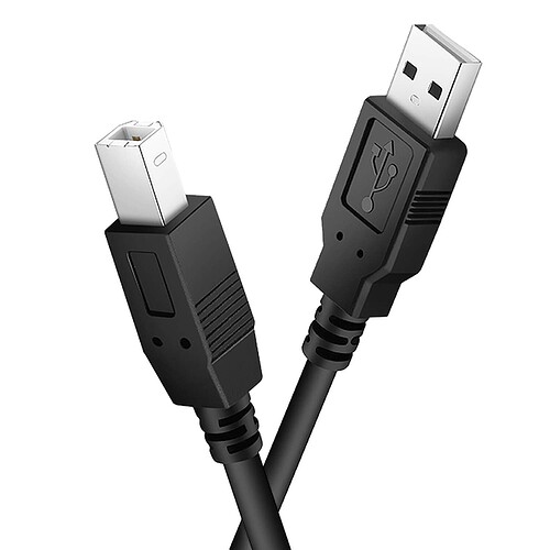

So, if I use this library, will the Arduino Leonardo receive MIDI messages directly through the USB cable that connects it to my PC? Because my piano sends MIDI messages through a cable like this
and then the message was sent to the Arduino through Hairless.
No i don't think so, that means i am not a 100% sure what you mean, but if your piano connects to your PC through a USB cable, what do you need the Arduino for ?
