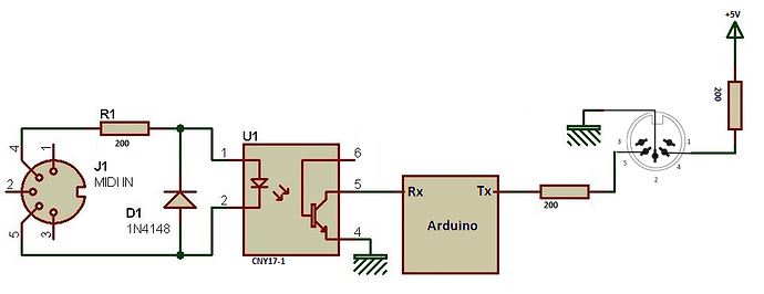

Hello,
Another MIDI receiving problem ...
  • I use a CNY17-1 optocoupler (datasheet says 40 to 80% CTR) on the serial port of an arduino pro mini 5V/16 MHz (schematic in attachment).
  • I can send messages with the TX/output circuit, no problem, but if I try to decode/receive messages with the RX circuit ... it's a disaster ...
  • I use a third party app and a MIDI keyboard but if I check the messages received by the arduino using the simplests sketchs they are wrong
Regarding schematic, if I use a pullup resistor on RX pin it just doesn't work, neither if I put the base at GND with resistor, the only solution to get some bytes received by the arduino is to connect directly CNY17 collector's to Arduino's RX pin
The sketch is the simplest serial repeater :
Here's what I get on third part Midi software :
 - emited via PC's MIDI output on Arduino's RX :
   [Midi-Out] - 90 3C 40
 - received by Arduino and transmitted on PC's MIDI input :
    [MIDI-In1] - 90 00 30 (Note On)

I've also tested the schematic with a 4N25, no success neither

I think the only opto fast enough for MIDI speed is the 6N139.And I always use a 680R pull up on the RX pin.
Make sure you have wired up that receive socket as if you looking at it from the back of the socket.
Thanks Mike, I've bought some of these components and will give it a try.
For the wiring of the socket I've used the numbers printed directly on it so normally there is no problem on this part!
