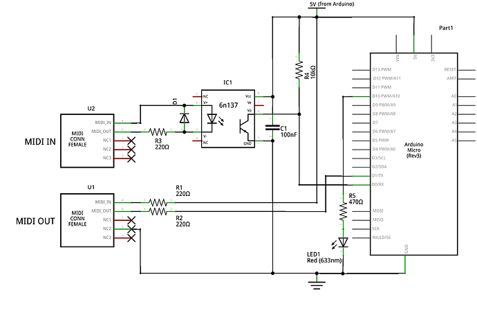

yes, but if your device have MIDI output you can connect it to DIY MIDI input on second serial of Micro

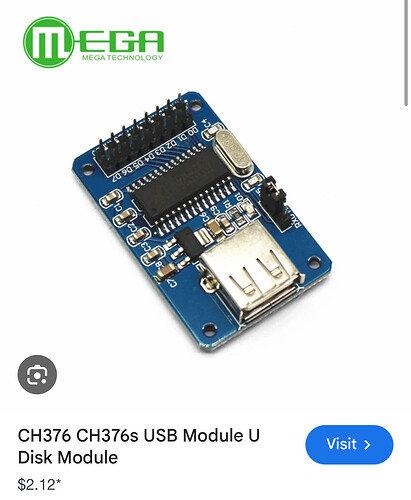

Nope. Simple usb host that provides a usb read function.
Probably like that one
The question was, which MIDI interfaces your keyboard provides. Many of them have - additionally to an USB interface - a 'classical' MIDI output ( the round DIN jack ). It would be much more easy to use this instead of an USB interface.

if you have such host module you can use any board
