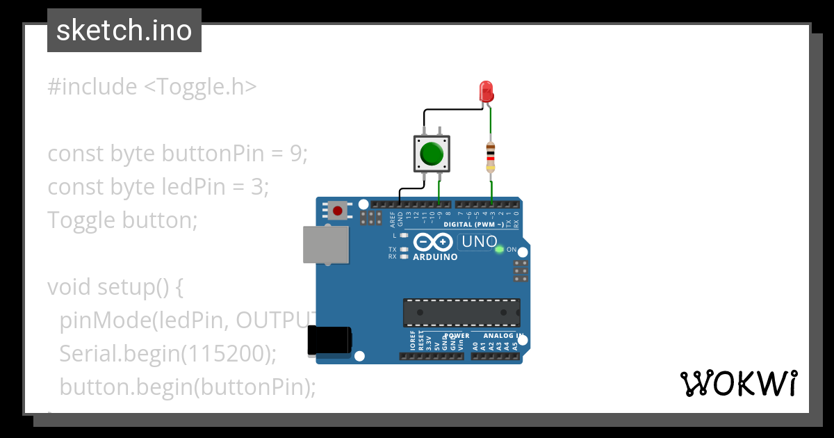

here is something to study and play with
I implemented a very simple state machine, if you read my tutorial I think you'll recognise the structure.

#include <Toggle.h>
const byte buttonPin = 9;
const byte ledPin = 3;
Toggle button;
unsigned long chrono, randomTime;
byte counter;
enum {STARTING, WAITING_PRESS, COUNTING_DOWN, IN_RANDOM_WAIT, WAITING_RELEASE} state = STARTING;
  pinMode(ledPin, OUTPUT);
  button.begin(buttonPin);
  // make sure we start with the button released
  while (true) {
    button.poll();
    if (button.isReleased()) break;
  button.poll();
  switch (state) {
    case STARTING:
      digitalWrite(ledPin, LOW);
      Serial.println(F("\n-------------------------------"));
      Serial.println(F("Ready, press and hold to start."));
      Serial.println(F("-------------------------------"));
      Serial.flush();
      state = WAITING_PRESS;
    case WAITING_PRESS:
      if (button.onPress()) {
        digitalWrite(ledPin, HIGH);
        chrono = millis();
        counter = 3;
        state = COUNTING_DOWN;
        Serial.println(counter);
    case COUNTING_DOWN:
      if (millis() - chrono >= 1000) {
        chrono = millis();
        Serial.println(--counter);
        if (counter == 0) {
          randomTime = random(5000);
          state = IN_RANDOM_WAIT;
      else if (button.onRelease()) {
        Serial.println(F("Released while counting down... It's waaay too early! You lost."));
        state = STARTING;
    case IN_RANDOM_WAIT:
        Serial.println(F("Released during random wait. It's too early! You lost."));
        state = STARTING;
      else if (millis() - chrono >= randomTime) {
        chrono = micros();
        state = WAITING_RELEASE;
    case WAITING_RELEASE:
        unsigned long reactionTime = micros() - chrono;
        Serial.print(F("Reaction time = "));
        Serial.print(reactionTime / 1000.0, 2);
        Serial.println(F(" ms."));
        state = STARTING;
Wow, this made the amount of code much smaller!

Everything seems to work fine now and I got a lot of good feedback which contributes to my knowledge of coding, but I can't help but be curious about one more thing:
Would there be an explanation for why the first called value through "Millis()" is larger than the second called value of the same function?
in which version of the code?
It is hard to say. The output in #1 doesn't seem possible from the code in #1. But in some places, it looks like the second value is set from a later call to mills():
